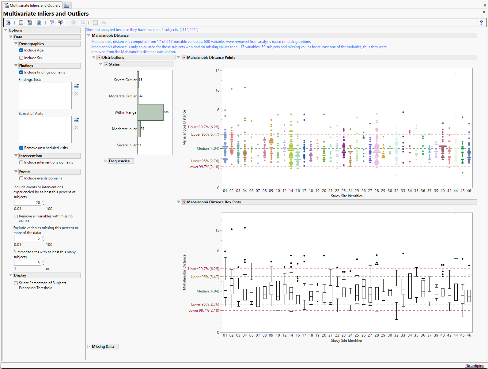

For the Nicardipine example shown here, 17 out of 617 variables have missing data rates below 5% and are kept. 50 subjects had missing values for at least one of these 17 variables, thus they were removed from the Mahalanobis distance calculation.
Running this report for Nicardipine using default settings generates the Report shown below.
The report initially shows two sections.

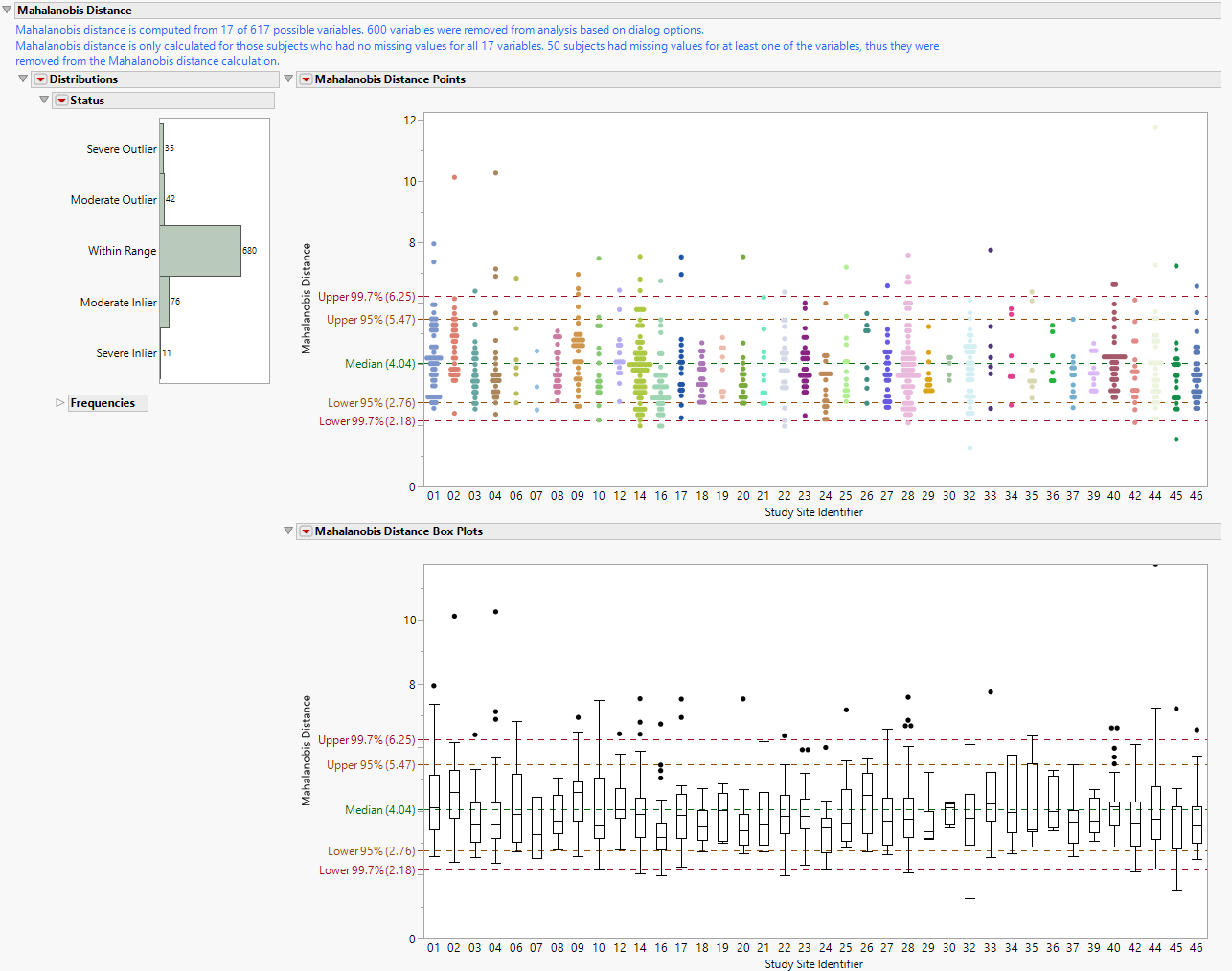

Mahalanobis Distance
Presents plots of Mahalanobis Distances of all subjects (distance is from the multivariate mean), colored by study site, and Box Plots presented by sites.
This section contains the following elements:
| • | One Status Distribution plot showing total subjects in each inlier/outlier grouping. |
| • | One JMP Mahalanobis Distances plot to identify significant outliers. In the Mahalanobis Distances plot shown above, the distance of each specific observation from the mean center of the other observations from the site is plotted. Those points residing above the upper 95% confidence interval (outliers) or below the lower 95% confidence interval (inliers) correspond to those rows that warrant the most attention due to their significant distance from the mean center of all other observations. The region between 95% and 99.7% is referred to as a moderate inlier or outlier depending on whether it is in the lower or upper bounds, respectively. Beyond 99.7 is considered a severe outlier or inlier. |
| • | One Box Plot. |
The second figure replaces points seen in the Mahalanobis plot with box plots by study site. This allows the analyst to better determine how different sites are from the multivariate mean.

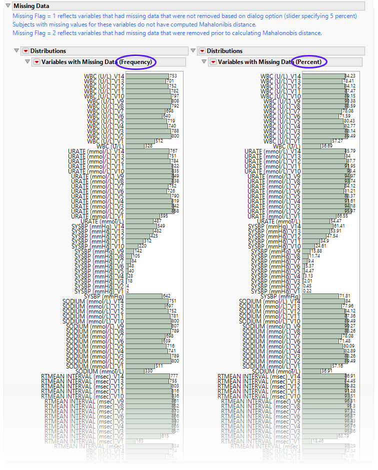

Missing Data
This section has the following elements:
| • | Two Histograms. |
Details variables that contain missing data that prevented Mahalanobis distances from being calculated for certain subjects (Flag = 1) or variables that were dropped from analysis. By default, variables with 5% or more of missing data are not used in the calculation of Mahalanobis Distance. Data are presented either as counts (left) or percentages (right) and reflect the number of values that are missing for each variable. Opening the data table shows the percentage of missing data for each test.

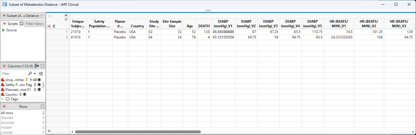

| • | Show Sites: Shows the rows of the data table for the selected points from Mahalanobis Distance Points or Box Plots graphs. Clicking opens the following table: |

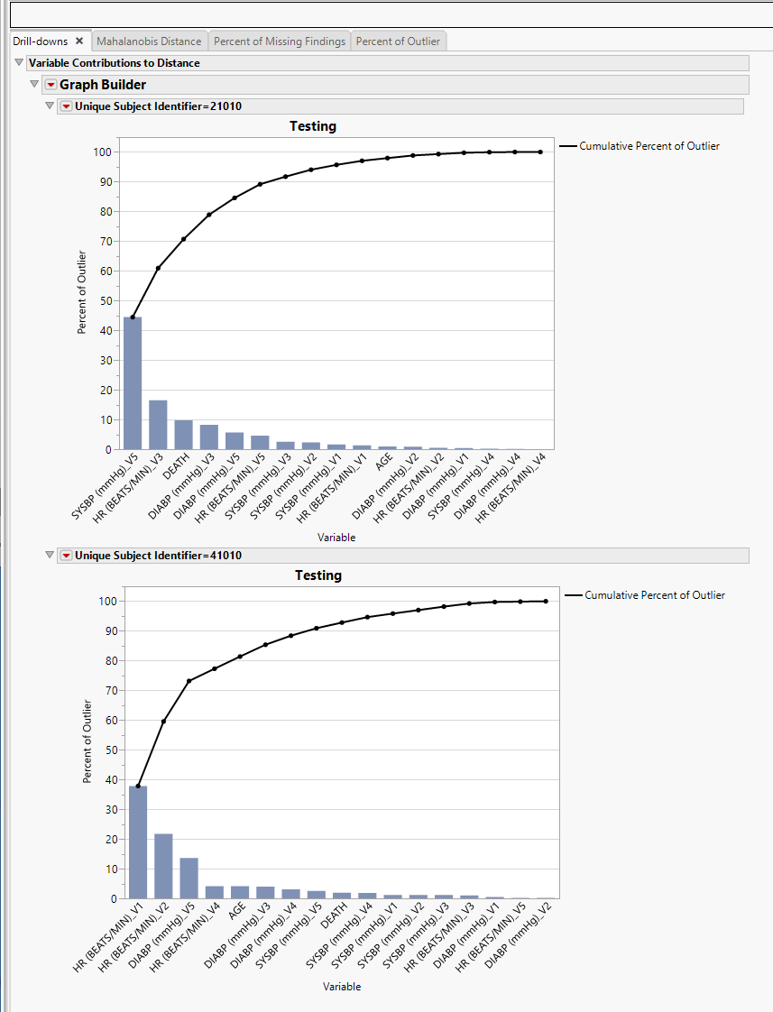

| • | Variable Contributions to Distance: Select subjects and click to create Pareto Plots for each subject that explain how much each variable contributes to a patient being an outlier, with a total possible of 100% for each subject. Analysis of the Pareto plots can enable you to view how selected subjects are extreme for the selected covariates. |

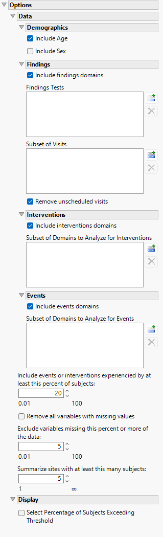

Options
Data
Include Age
Use this widget to include age of the subjects in the analysis.
Include Sex
Use this widget to include gender of the subjects in the analysis.
Include findings domains
Check this option to include data from the findings domains in the analysis.
Findings Tests
Use this widget to select Findings Tests for the analysis. The report will autorun and analysis is restricted to the selected tests only. This option is available only when the Include findings domains option is selected.
Subsets of Visits
Use the Subset of Visits option to select the visits to be included in the analysis.
Remove unscheduled visits
You might or might not want to include unscheduled visits when you are analyzing findings by visit. Check the Remove unscheduled visits to exclude unscheduled visits.
Include intervention domains
Check this box to include data from the Intervention domains in the analysis.
Subset of Domains to Analyze for Interventions
Use this widget to select specific subsets of the Interventions domains for the analysis. The report will autorun and analysis is restricted to the specified subdomains only. This option is available only when the Include intervention domains option is selected.
Include events domains
Check this box to include data from the Event domains in the analysis.
Subset of Domains to Analyze for Events
Use this widget to select specific subsets of the Event domains for the analysis. The report will autorun and analysis is restricted to the specified subdomains only. This option is available only when the Include events domains option is selected.
Include events or interventions experienced by at least this percent of subjects
The Include events or interventions experienced by at least this percent of subjects widget enables you to set a threshold number of subjects that must experience an event/intervention for it to be considered significant enough to be included in the analysis.
Remove all variables with missing values
Check this option to remove any variables with missing data from the analysis.
Exclude variables missing this percent or more of the data:
The Exclude variables missing this percent or more of the data: widget enables you to set a maximum percentage of missing data a variable may contain to be included in the analysis. Variables containing missing data exceeding the percentage specified here are excluded from the analysis.
Summarize sites with at least this many subjects
The Summarize sites with at least this many subjects: widget enables you to set a minimal threshold for the sites to be analyzed. Only those sites which exceed the specified number of subjects are included. This feature is useful because it enables you to exclude smaller sites, where small differences due to random events are more likely to appear more significant than they truly are. In larger sites, observed differences from expected attendance due to random events are more likely to be significant because any deviations due to random events are less likely to be observed.
