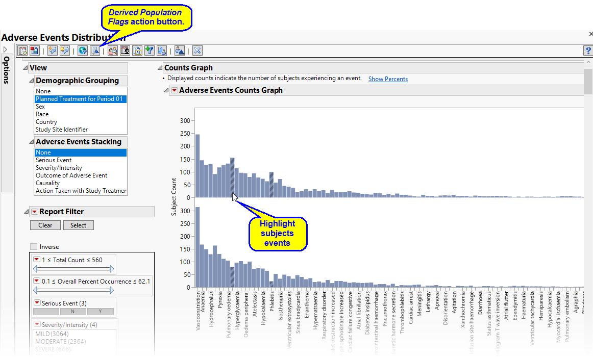

In the first step, we ran the Adverse Events Distribution report on the Nicardipine study using the default settings.
Both hypotension and phlebitis occurred with relatively higher frequency than other events among patients receiving Nicardipine than in those receiving a placebo. These events were selected for both treatment groups.

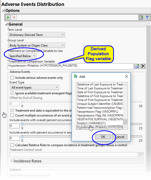

Clicking opens the Add window, shown below.
Hypotension-Phlebitis was specified as a label for the flag. The default variable name DERIVEDFLAG was used. Clicking added a flagged variable to the data set called DERIVEDFLAG . Values for this variable are either Y if a subject exhibits either hypotension or phlebitis or N, if a subject does not. It is also possible for a derived flag to have missing values. This will happen if the report in which selections are being made is run with a subject filter.
The report was run a second time. However, the Treatment or Comparison Variable to use was changed to Specified Below and the new Hypotension-Phlebitis derived flag variable was specified as the treatment variable.

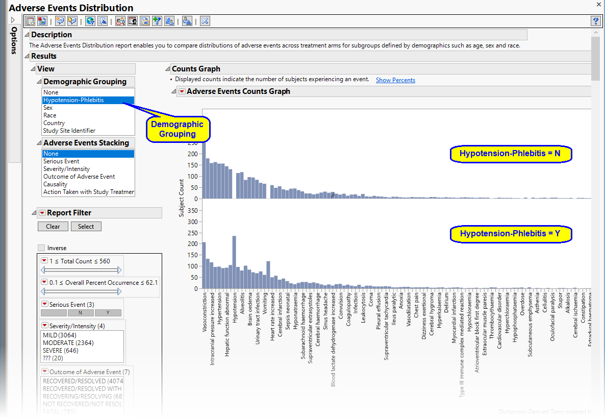

The results of this second run are shown below:
The distributions of the events for each demographic group (subjects exhibiting the flagged effects vs. subjects not exhibiting these effects) are shown. The groups can be compared and further explored.
