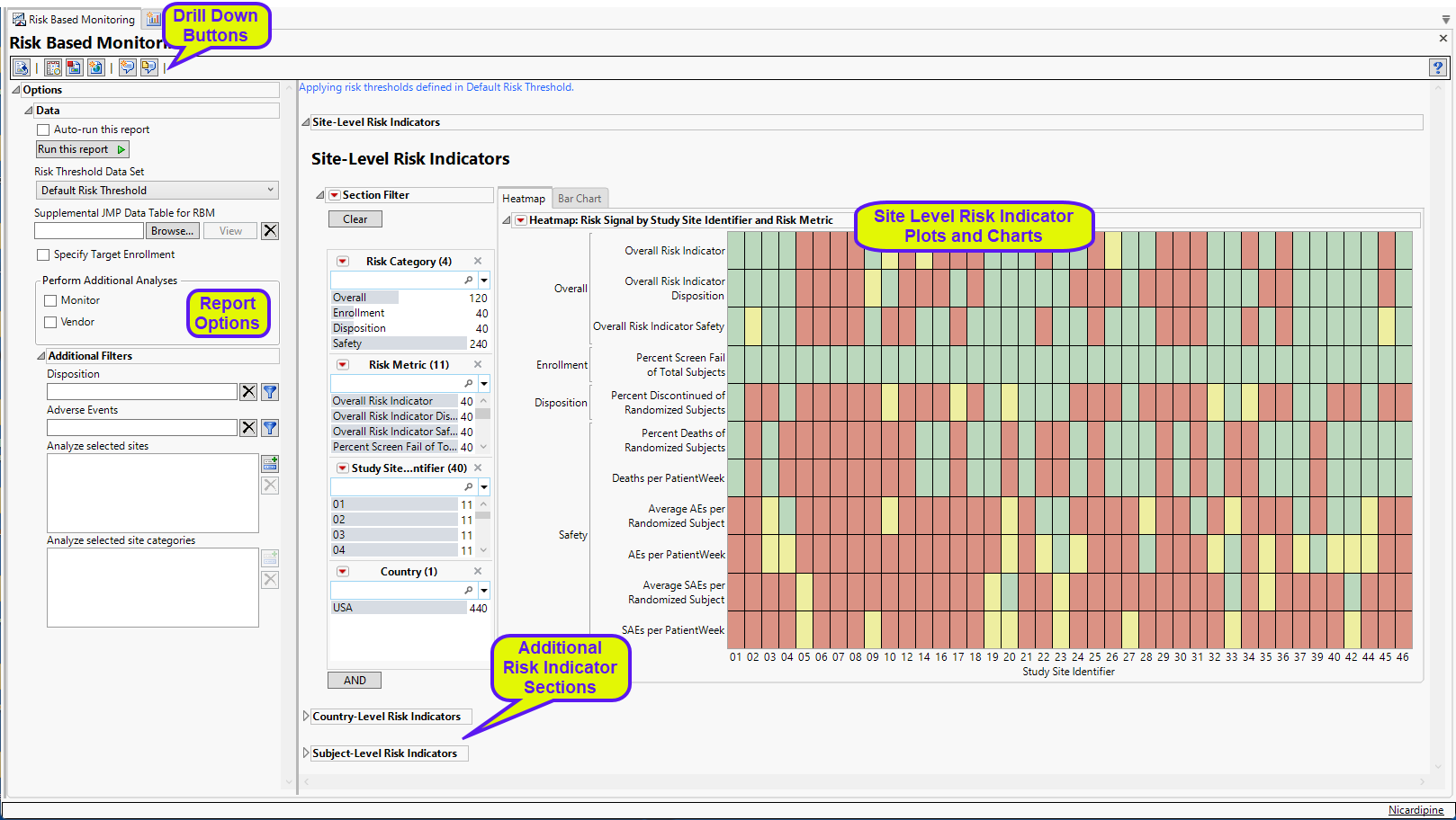

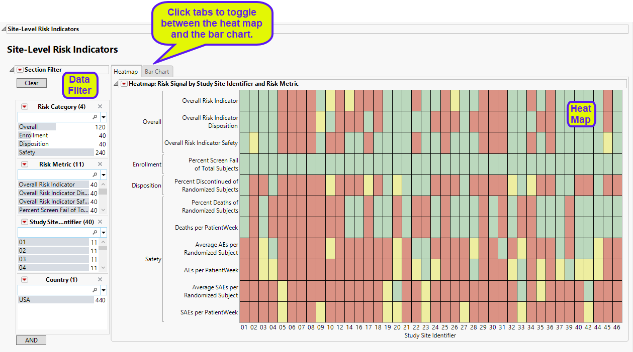

Site-Level Risk Indicators
The Site-Level Risk Indicators section contains the following elements:
• A heat map of the various risk indicators by Site Identifiers. Individual blocks are colored by the relative severity of each indicator at that site: red = severe, yellow = moderate, green = mild or none. This section enables you to view the distribution of risk indicators across sites, possibly identifying any outliers.

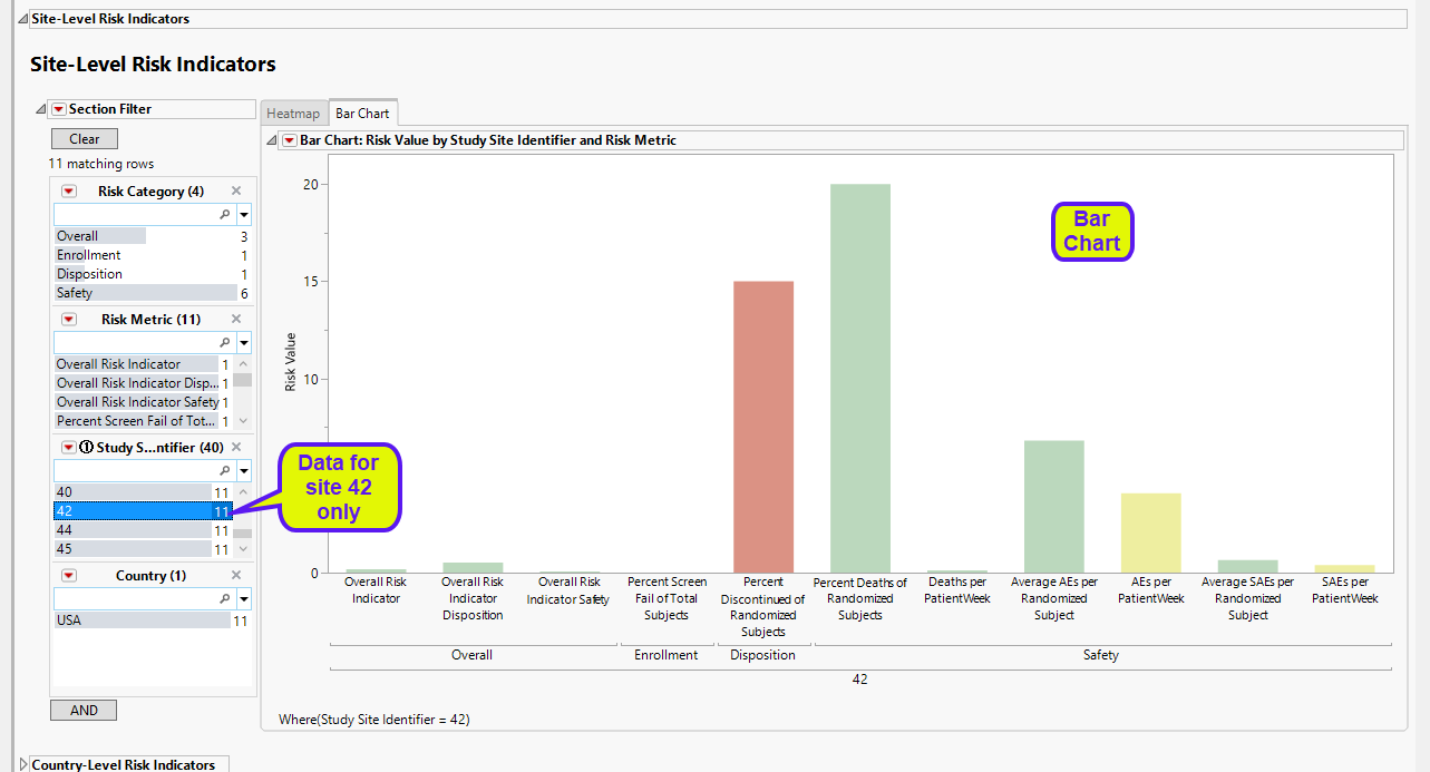

• A Section Filter to filter to data of interest, for example, to risk indicators that belong to a particular site.

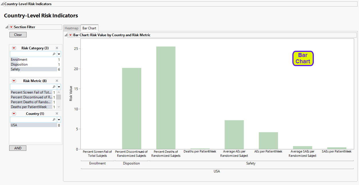

• A bar chart showing the risk value for each indicator across the sites. The data in the following bar chart were filtered to site 42 only.

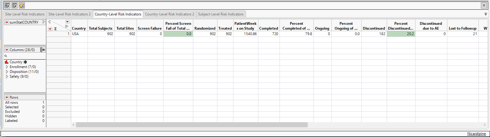

Country-Level Risk Indicators
The Country-Level Risk Indicators section contains the following elements:

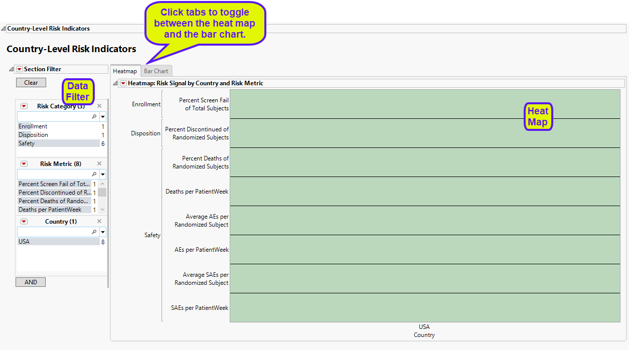

• A heat map of the various risk indicators by Country Identifiers. Individual blocks are colored by the relative severity of each indicator at that site: red = severe, yellow = moderate, green = mild or none. This section enables you to view the distribution of risk indicators across countries, possibly identifying any outliers.
• Note: All of the trial sites are located within the United States, so only one country is displayed.
• A Section Filter to filter to data of interest, for example, to risk indicators that belong to certain risk categories.
• A bar chart showing the risk value for each indicator . across the sites.

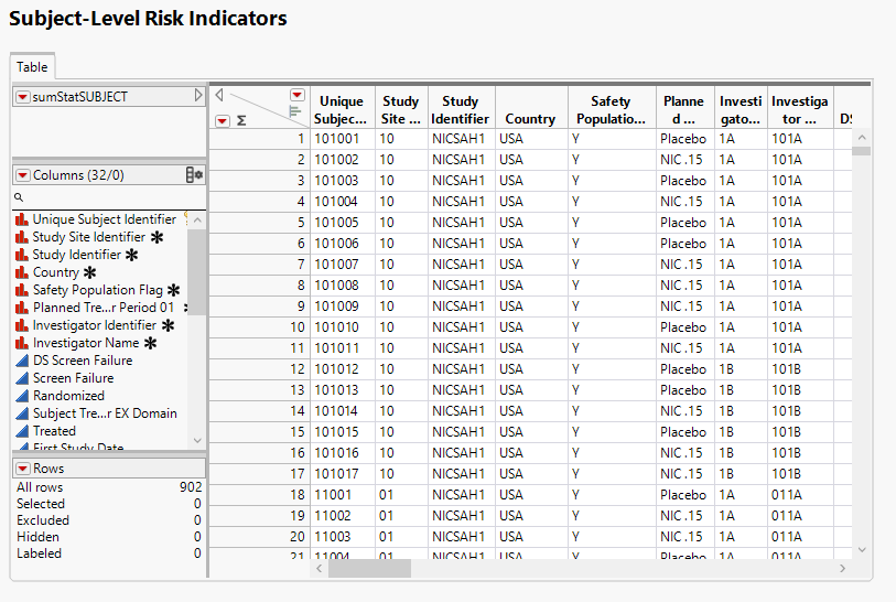

The Subject-Level Risk Indicators section contains the following elements:
• A table listing the risk indicators of each subject.

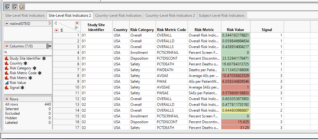

Output Data
You can view the output data tables by clicking on the action button. The data tables display risk indicators derived using the study database as well as data included in the optional supplemental data set. Two data tables are generated for each level except subject-level. The two tables at each level contain the same information, but they are organized differently.

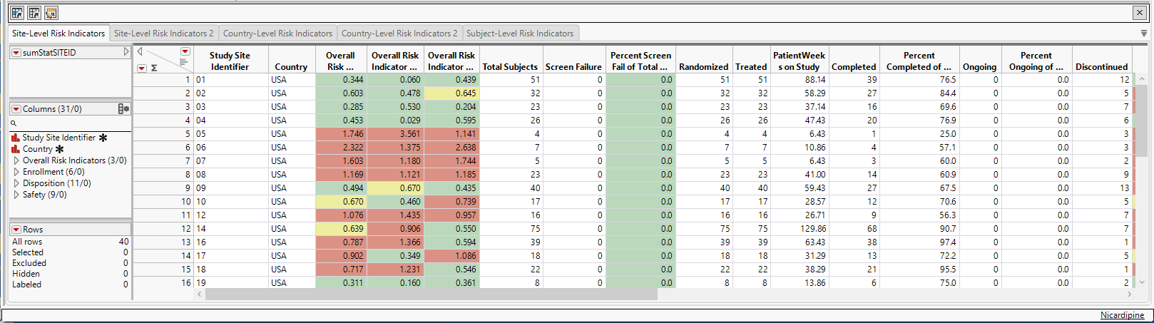

• Site-Level Risk Indicators: This data table displays risk indicators summarized at the site level. Risk indicators with defined thresholds are colored in green, yellow, or red. Each site-level risk indicator is in a separate column. This is a "short" and "wide" data table.
• Site-Level Risk Indicators 2: This data table displays risk indicators summarized at the site level. It contains only those risk indicators that have a defined threshold and they are colored in green, yellow, or red. All the risk values are stacked in the same column: Risk Value. The risk indicator name is stored in the Risk Metric column. This is a "long" and "narrow" data table.

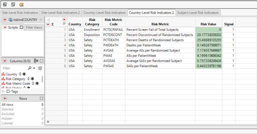

• Country-Level Risk Indicators: This data table displays risk indicators summarized at the country level. Risk indicators with defined thresholds are colored in green, yellow, or red. Each country-level risk indicator is in a separate column. This is a "short" and "wide" data table.
• Country-Level Risk Indicators 2: This data table displays risk indicators summarized at the country level. It contains only those risk indicators that have a defined threshold and they are colored in green, yellow, or red. All the risk values are stacked in the same column: Risk Value. The risk indicator name is stored in the Risk Metric column. This is a "long" and "narrow" data table.
• Subject-Level Risk Indicators
This is the same table displayed in the Subject-Level Risk Indicators section above.

Options
Data
Use the options on this panel to customize your analysis.
Auto run this report
Check this box to auto run this report upon opening using specified study preferences
