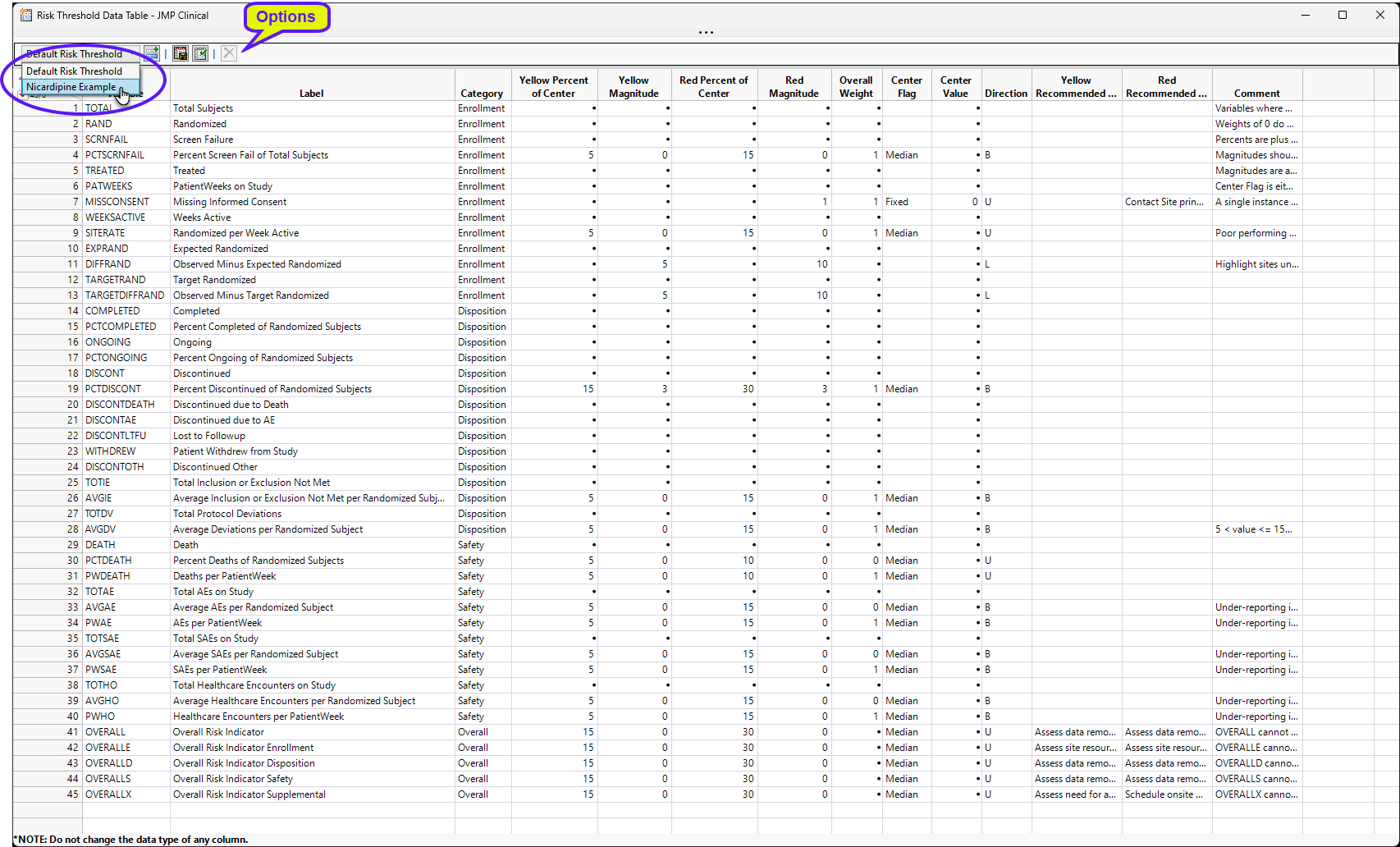

This option opens the Risk Threshold data set, enabling you to manually add, subtract, or modify the risk threshold data.
Refer to How does JMP Clinical define various terms for risk based monitoring? and How are risk thresholds defined? for more information.
To Make Changes to the Risk Threshold Data Set:
| 8 | Use the drop-down menu to select the desired Risk Threshold data set, as shown above. |
| 8 | Click to add a new row. Data is then entered manually. |
| 8 | Click to save the Risk Threshold data set. |
| 8 | Click to check the validity of the data in the Risk Threshold data set. A PDF listing any problems, such as missing data, is generated. |
| 8 | Click to delete the data set. |
