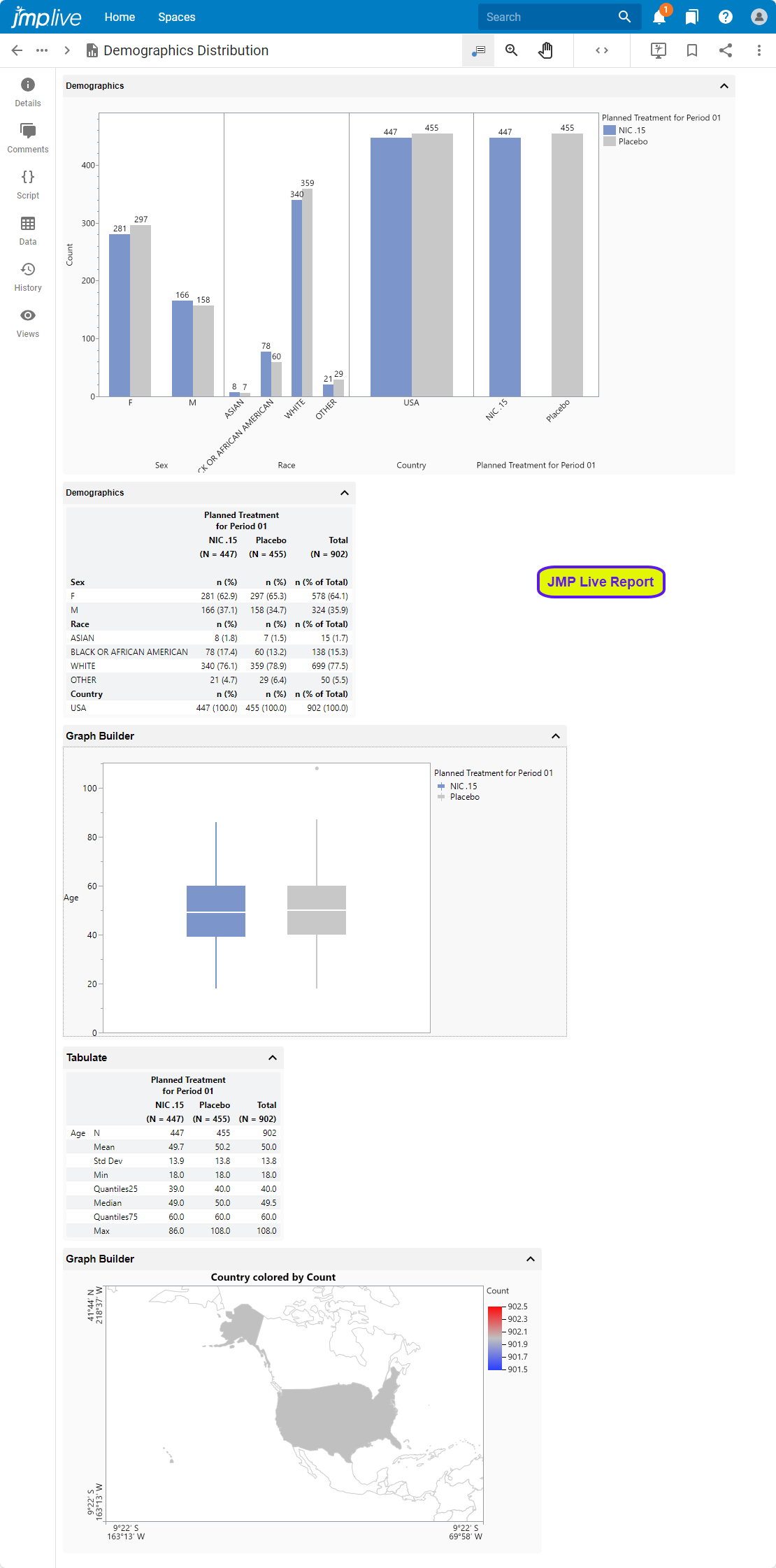

The JMP Live Report
The JMP Live Report, shown below, was generated after running the Demographics Distribution report using the Nicardipine sample data set.

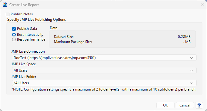

Report Options
The following options enable you to tailor the JMP Live report to your specific needs:
Publish Data
Check the box to include all data sets with your JMP Live report. You can choose to format the data for Best interactivity, where all supported aspects of the report are fully interactive, or Best performance, where images and graphs are not interactive, but supported data in the rest of the report remains interactive.
Note: If your data set is large, you might choose Best performance to increase the responsiveness of the report.
Publish Notes
Check the box to append the study notes to the end of your JMP Live report.
Best interactivity
Click this button to make all supported aspects of the report fully interactive.
Best performance
Click this button to make supported data this report interactive. Images and graphs do not remain interactive, however. Select this option when yur data set is large to increase the responsiveness of the report.
Data
The size of your data set(s) is shown as the Dataset Size:.
JMP Live Connection
Displays the URL to which you are publishing.
JMP Live Space
Use this widget to specify the space within the server where your report will be placed.
JMP Live Folder
Use this option to select a folder within the JMP Live Space where your report will be placed.

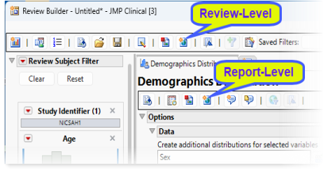

Publish a single Report or the whole Review
There are two Create Live Report buttons on the Review Builder, one for publishing the active report and one for publishing the entire review.
8 Click the Report-Level button to publish the active report only (in this example, Demographic Distribution) to JMP Live.
8 Click the Review-Level button to publish the entire review to JMP Live.
The Create Live Report window and associated options are the same for both.

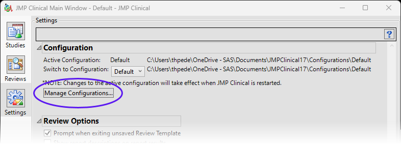

8 Open JMP Clinical and click on the Settings button.
8 Click

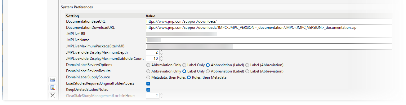

8 Add your assigned JMP Live URL and JMP Live Name to the appropriate rows in the System Preferences box on the Manage Configurations window.
8 Click to close the Manage Configurations window.

Note: The JMP Live URL is the URL to the JMP Live instance. If more than one JMP Live instance, separate with vertical bars (|). The JMP Live Name is the name of your choice corresponding to each JMP Live instance. If you have more than one JMP Live instance, separate with vertical bars (|).
