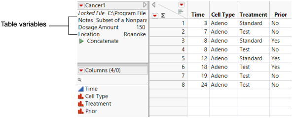

A data table variable can contain textual information (for example, source information for the data), or a value that can be used by column formulas or JSL scripts. Data table variable names appear in the table panel at the left of the data grid.
Figure 4.62 Table Variables in the Table Panel

Table variables are used primarily to document tables. Many sample data tables installed with JMP contain a table variable named Notes. This variable provides details about the data (for example, the source of the data). The example in Figure 4.62 shows a data table that contains Notes as one of its table variables. JMP also automatically creates table variables when you create a design table using the Design of Experiments commands in JMP. The design table has a table variable named Design with the name of the design type as its value.
