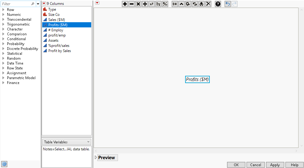

The Formula Editor opens. The blue outline around the box in the editing window indicates that the box is selected.
5. With the box selected, select Profits ($M) from the Columns list.
Figure 7.3 Adding the Profits ($M) Column
