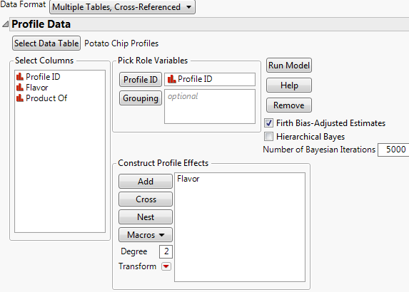

5. Click Select Data Table under Profile Data.
A Profile Data Table window appears, which prompts you to specify the data table for the profile data.
6. Select Potato Chip Profiles and click OK.
The columns from this table appear in the Select Columns.
7. Select Profile ID from the Select Columns list and click Profile ID under Pick Role Variables.
8. Select Flavor and click Add under Construct Profile Effects.
Note that Product Of is another profile effect that you could add to the effects list.
Figure 5.5 Complete Profile Data Outline
