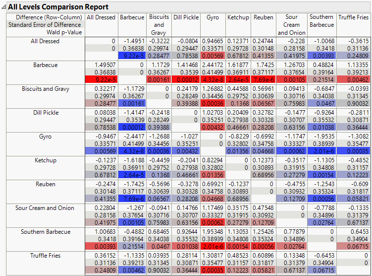

Figure 5.1 MaxDiff All Comparisons Report
