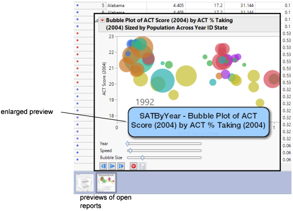

To open an associated report when you are viewing a data table, double-click the thumbnail preview of the report in the bottom pane. To enlarge the preview, hover over the thumbnail (Figure 2.16).
Middle-click the thumbnail preview to close the associated report.
Figure 2.16 Thumbnail Previews of Open Reports
