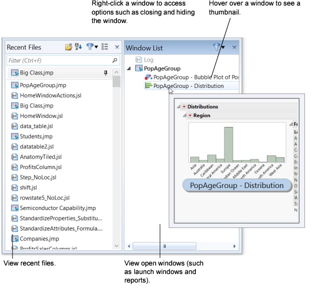

JMP Home Window on Windows
On Windows, the JMP Home Window appears when you open JMP.
Open recent files in the Recent Files list or pin a frequently used file.
Right-click files in the Recent Files list to perform common tasks.
Open or close active JMP windows in the Window List.
Set an open data table as the current data table by selecting it from the data table list at the top.
Figure 2.14 JMP Home Window Actions

Recent Files
On Windows, the Recent Files list provides quick access to files that you recently opened.
Keep your favorite files at the top of the list for quick access. Hover over the filename and click the pin icon Image shown here. To unpin a file, click the pin iconImage shown here.
You can drag files from the Recent Files list into these locations:
the JMP Window List to open the file
a Windows folder or on to your desktop to create a copy of the file
applications such as Microsoft Notepad or Microsoft Word to edit the file

Window List
On Windows, the Window List shows open JMP windows, such as data tables, reports, and scripts. You can open, close, rearrange, and hide JMP windows.
If you hover over a file in the Window List, a thumbnail appears.
To open the Window List in its own window, select View > Window List.
To display windows side-by-side, right-click the selected windows and select Arrange.
To always automatically display the Window List inside maximized windows, select File > Preferences > Windows Specific and select Dock the Window List in maximized windows.
