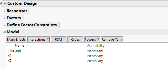

Model
Specify your assumed model (which contains all the effects that you want to estimate) in the Custom Design Model section. For each effect that you specify, you can designate that effect’s Estimability. The Estimability value indicates whether it is Necessary to estimate that effect, or if you are content to estimate that effect If Possible.
The initial Model section includes the main effects for all factors. If you have entered a discrete numeric factor with three or more levels, polynomial terms are also included in the initial model. The Estimability of second-and higher-order terms is set to If Possible. If you want to ensure that these terms are estimable, change their Estimability to Necessary.
Note: You can ensure that the estimability of discrete numeric polynomial terms is always set to Necessary. Select File > Preferences > Platforms > DOE. Check Discrete Numeric Powers Set to Necessary.
Figure 4.20 Model Section
Model Section
When you construct your design table, JMP saves a Model script to the data table. Except for discrete numeric factors, the Model script contains the effects shown in the Model section. For a discrete numeric factor, the Model script contains only its main effect and quadratic term.
The Model section contains the following buttons and fields:
Main Effects
Adds main effects for all factors in the model, and polynomial terms for discrete numeric factors.

Name
The name of the effect.
Estimability
A designation of your need to estimate the effect.
If Estimability is set to Necessary, the algorithm ensures that the effect is estimable.
If Estimability is set to If Possible, the algorithm attempts to make that effect estimable, as permitted by the number of runs that you specify.
Except for polynomial terms for discrete numeric factors, all effects are specified as Necessary by default. Click an effect’s Estimability value to change it.
