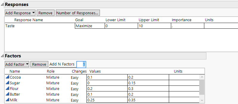

2. Double-click Y under Response Name and type Taste.
Note that the default goal is Maximize. Because you want to maximize the Taste rating, do not change the goal.
3. Click under Lower Limit and type 0.
The least desirable rating is 0.
4. Click under Upper Limit and type 10.
The most desirable rating is 10.
5. Leave the area under Importance blank.
Because there is only one response, that response is given Importance 1 by default.
6. Select Help > Sample Data Folder and open Design Experiment/Cake Factors.jmp.
7. Click the Custom Design red triangle and select Load Factors.
Figure 5.54 Completed Responses and Factors
Note that the factors are all mixture factors. The Values that define the range of settings for the experiment vary from factor to factor.

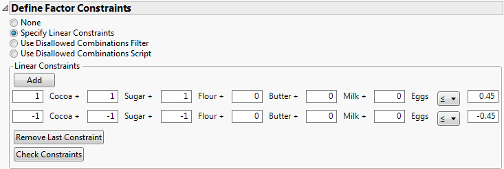

8. In the Define Factor Constraints section, select Specify Linear Constraints.
9. In the Linear Constraints panel, click Add twice.
10. Enter the constraints shown in Figure 5.55.
Figure 5.55 Define Factor Constraints
Note that the second constraint is equivalent to specifying that the sum of Cocoa, Sugar, and Flour is greater than or equal to 0.45. The two constraints together imply that Cocoa, Sugar, and Flour comprise exactly 45% of the mixture, ensuring that the wet factors constitute the remaining 55%.

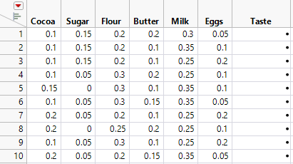

15. Click Make Design.
A JMP Alert informs you that your factor constraints include an equality constraint. This was what you intended, because the sum of the dry ingredient proportions is constrained to 45%.
16. Click OK to dismiss the JMP Alert.
17. Click Make Table.
Figure 5.56 Mixture of Mixtures Design
The settings for the dry ingredients, Cocoa, Sugar, and Flour, sum to 45% of the mixture and the settings for the wet ingredients, Butter, Milk, and Eggs, sum to 55% of the mixture. The settings also conform to the upper and lower limits given in the Factors section.

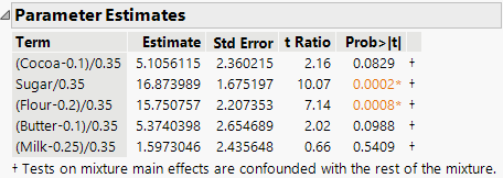

The Cake Data.jmp sample data table shows the results of the experiment. The design table contains a Model script that opens a Fit Model window showing the five main effects specified in the DOE window’s Model section. Notice that the main effect of Eggs is not included in the Model section for this design. The level of Eggs can be determined by the settings of the other 5 factors and the constraint on the dry ingredients. This script was saved to the data table when it was created by Custom Design.
1. Open the Cake Data.jmp sample data table, located in the Design Experiment folder.
2. In the Table panel of the design table, click the green triangle next to the Model script.
The main effect due to Eggs is not included. To avoid model singularities, the Eggs effect was excluded from the Model section in the Custom Design window. The five effects are designated as Response Surface and Mixture effects.
3. Click Run.
A JMP Alert appears, notifying you that the Profiler cannot be shown because of the mixture of mixtures constraint on the subsets of factors.
4. Click OK to dismiss the JMP Alert.
The Parameter Estimates report indicates that Sugar and Flour are significant at the 0.05 level.
