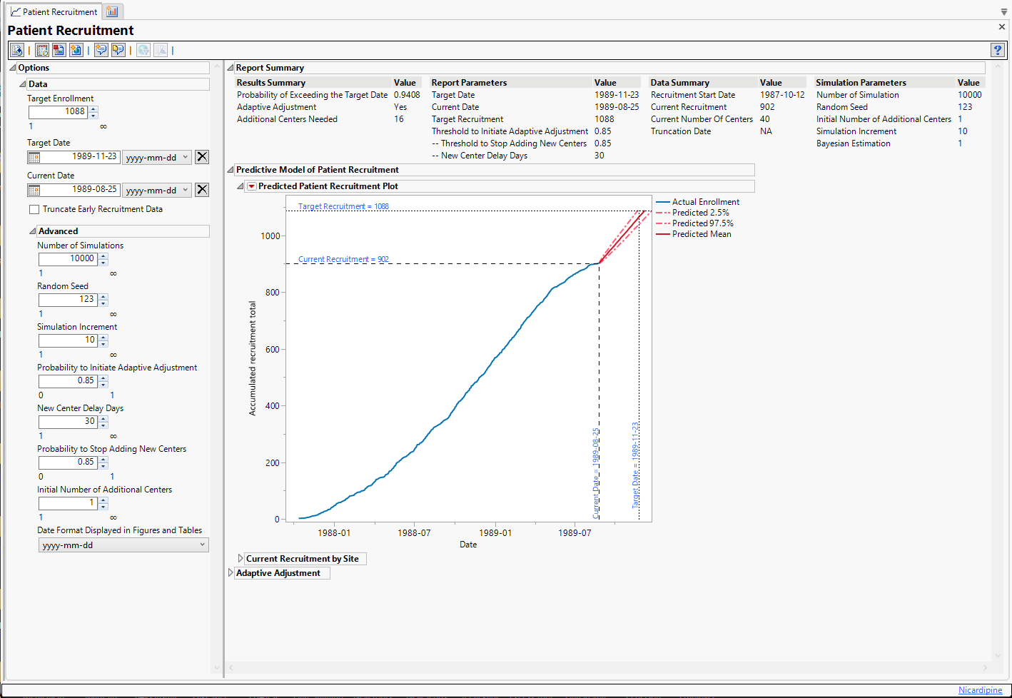

Running Patient Recruitment for the Nicardipine study with a target goal of recruiting 600 additional subjects within 7 months generates the report shown below:
Note: The recruitment target number and date in the example shown here were chosen to ensure that the Adaptive Adjustment algorithm was invoked.
The report consists of the following elements:

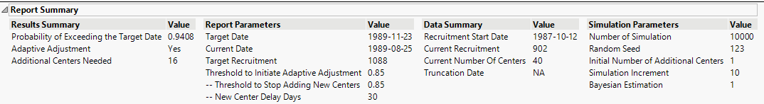

Report Summary
Displays a summary of the study, parameters used in simulations, and predicted results with regards to patient recruitment.

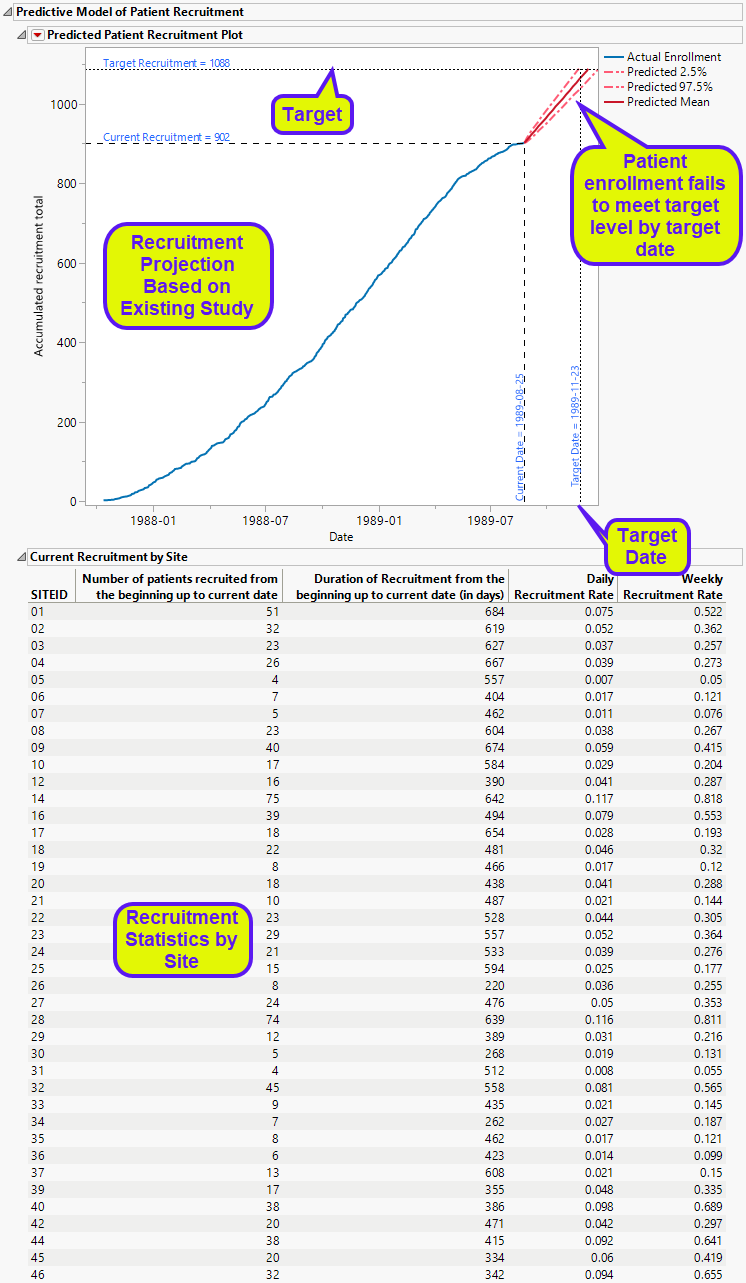

Predictive Model of Patient Recruitment
Displays recruitment history and predictions.
This section contains the following
One plot showing patient recruitment over time along with the projected recruitment, based on recruitment history and assuming the number of study sites remains the same. Target recruitment numbers and deadline are indicated. To meet study requirements, projected enrollments must reach target levels before the deadline.
In this example, projections suggest that, given the established number of study sites and rate of recruitment, the study will fail to recruit the desired number of subjects by the target date.
One table summarizing recruitment statistics.
Note: When predicted subject enrollment is insufficient, as shown in this example, the Adaptive Adjustment protocol is invoked.

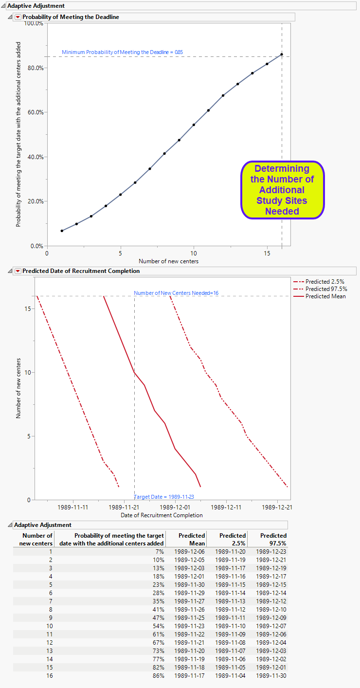

Adaptive Adjustment
Displays the predicted probability of meeting the target date with the additional centers added, and the Date of Recruitment Completion as the number of new centers increases.
Note: This section is displayed only when recruitment is predicted to be insufficient.
The Adaptive Adjustment section contains the following elements:
One plot showing the predicted probability of meeting the target date with the additional centers added, with a reference line for the Minimum Probability of Meeting the Deadline at 85% (by default).
In this example, a minimum of 16 additional centers are needed to meet recruitment goal by the target date.
One plot showing the expected date of completion, given different numbers of additional centers.
In this example, the predicted date of completion is met only by the addition of 16 new centers.
One table summarizing the adjustment statistics.
