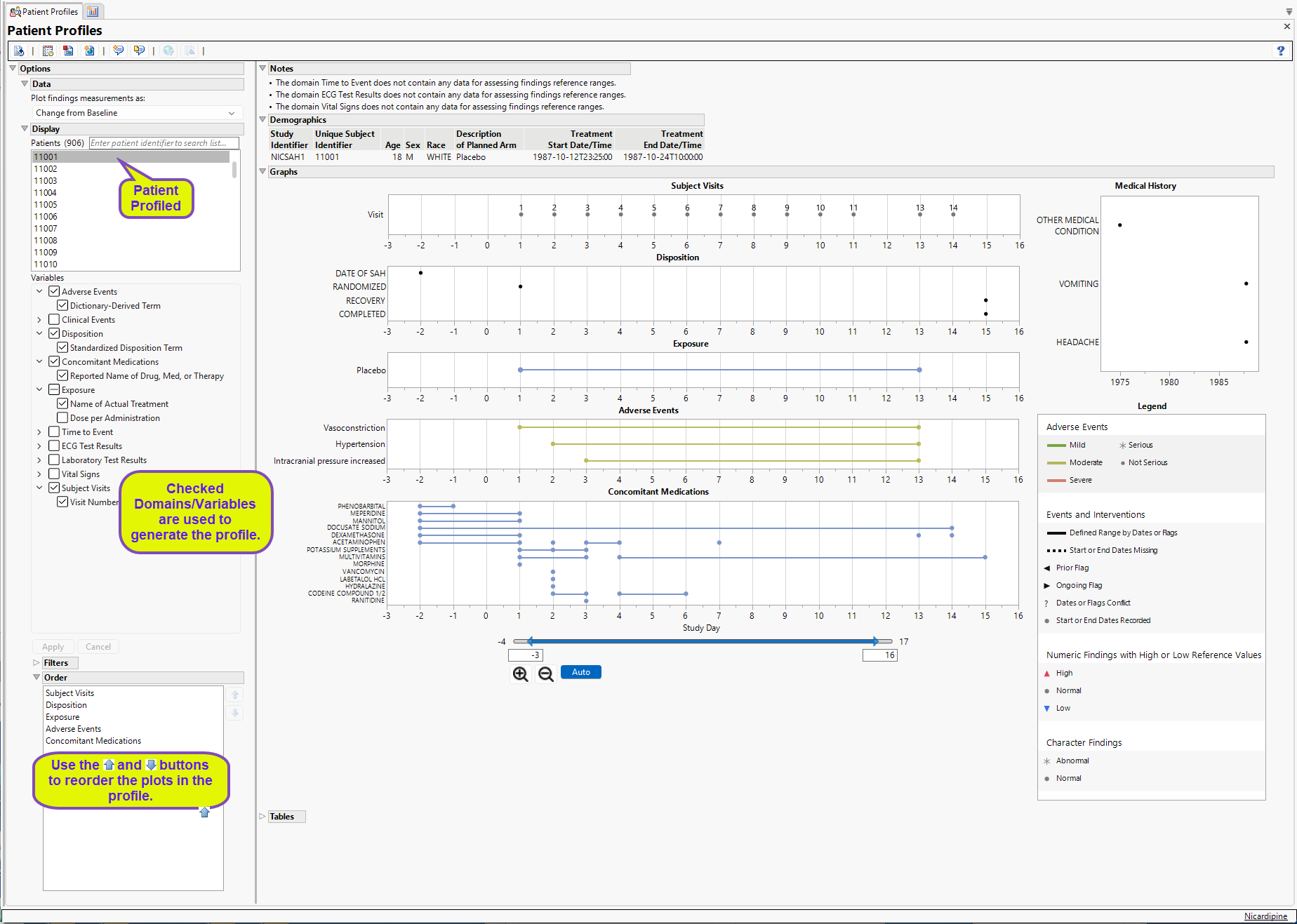

Running this report for the Nicardipine example using default settings generates the Report shown below.

The Patient Profiler window contains the following elements:
Demographics
This table displays a simple table of the basic demographics for the currently profiled patient(s).
In the example shown here, one patient was profiled.
Graphs
The Graphs tab contains the following elements:
• One Subject Profile.
This is the principal display. Time is displayed along the x-axis and data values from selected domains are grouped along the y-axis. When duration information is available, points are joined with a horizontal line.
Note: When calculating time, the start day for a record is used as the anchor point from which other elements of that row a drawn. The start day is computed from xxSTDY, xxSTDC, xxDY, xxRFSTDC, and/or xxDTC, depending on the domain. When either the reference or treatment start day is missing and the end day is not, the start day is set equal to the end day minus one. If both are missing, the start day is set equal to 0.
Note: For interventions domain, xxTRT is required, xxDECOD is permissible. For Events domains, xxTERM and xxDECOD are both required. When generating the graphs, xxTRT takes precedence for Interventiondomains and xxDECOD takes precedence for Events domains.
8 Use the slider and zoom controls below the plot to adjust the view. Click to reset the view to the default view.
The color and shape of points is domain dependent and is described in the Legend pane.
• One Medical History plot showing significant events and the year they were reported.
• One Legend.

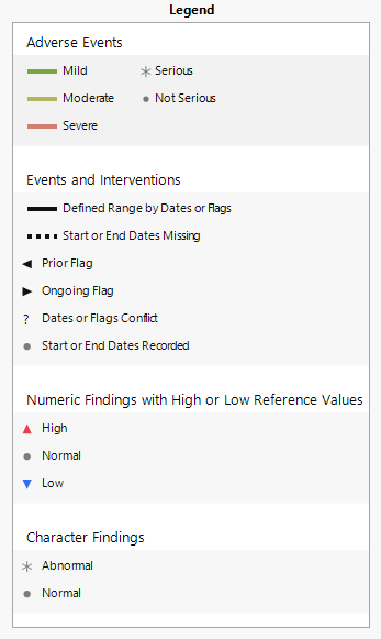

This pane describes the colors and symbols used in the primary display.
The top panel (shown below) denotes symbols and colors used for adverse events. Blue, green, or red bars indicate that the events are mild, moderate, or severe, respectively, as specified by the values in the SDTM variable aesev
. When you specify aetoxgr instead of aesev in your AE or ADAE domain, the color scale has four levels instead of 3.
Note: For both cases (aesev and aetoxgr) shown above, the colors can be changed at the Study level using the Set Value Order and Color in Studies... option.
The asterisk () and filled-circle ( ), in both cases, indicate whether the condition is serious or not serious, respectively, as specified by the values in the variable aeser.
Note: Serious conditions are generally, but not necessarily, severe.
The middle panel (shown below) denotes line formats and symbols used for dates and times of different events and interventions.
Events or interventions with a defined range are indicated by a solid line spanning the ranges. Events or interventions with unknown start or end dates are indicated by a dashed line. Flagged events are indicated by left (prior) or right (ongoing) arrows. Conflicts are indicated by question marks. Start and End dates are denoted by a filled-circle ().
When processing the flag variables xxSTRF and xxENRF, the patient profiler checks for the following keywords: "NOT RECOVERED/NOT RESOLVED", "NOT RECOVERED/RESOLVED", "NOT RECOVERED", "NOT RESOLVED", "RECOVERING/RESOLVING", "RECOVERING", "RESOLVING", "CONTINUING", "ONGOING". If one of these keywords is specified and also a corresponding start or end date is specified, the profile will display a "?" to represent a data conflict.
The bottom panel (shown below) differentiates levels of findings for numeric and character findings.
Numeric findings that exceed the specified maximum reference value (also defined as the upper limit of normal or ULN) are indicated by an upward arrow ( ). Findings that fall below the specified minimum reference value (also defined as the lower limit of normal or LLN) are indicated by a downward arrow ( ). Findings between the ULN and LLN are indicated by a filled-circle (). The normal range is considered to be the median value over all subjects +/- 1.5 x the interquartile range (IQR). Findings falling within that range are are indicated by a filled-circle ( ).
Normal character finding are indicated with a filled circle ( ). Character findings considered abnormal are indicated by an asterisk ( ).

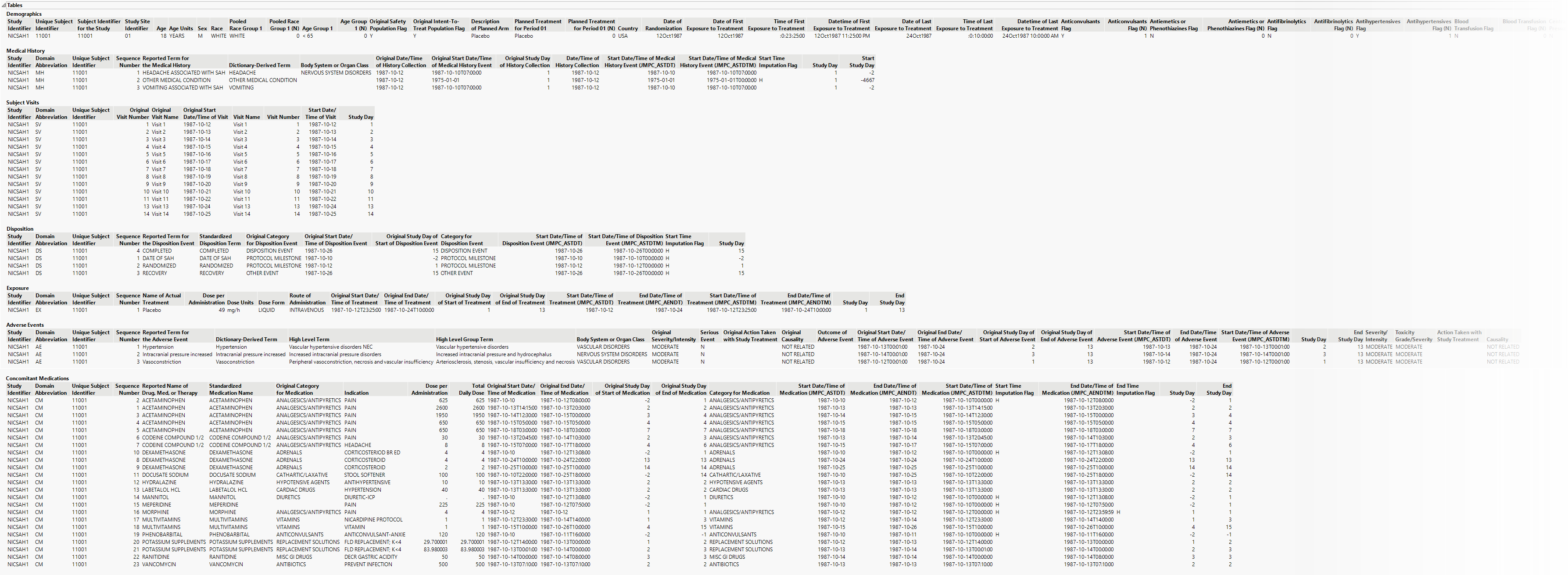

The Tables section lists and summarizes subject-level data for the profiled subject in tabular form.

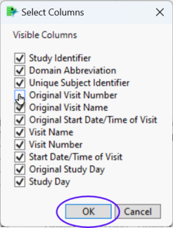

There may be circumstances in which a user might want to limit the columns shown in one or more of the profile tables. You can use JMP's column selection option to specify which columns are shown in the tables and which columns are hidden. These specifications can be saved to a template that can used repeatedly through the analysis.
In this example, we hide the Original Visit Number column (circled below) in the Study Visits table.
To hide one or more columns from a table:
8 Mouse over the table you want to modify and right-click.
8 Select Columns > Column Selection from the pop-up menus to open the Select Columns window.
8 Deselect the Original Visit Number column check box and click to hide the column in the table.
8 To display the column again, repeat this procedure and reselect the Original Visit Number column checkbox.
8 To save the template for use in further analyses, click to save the template (see Saving a Review Template for more information).

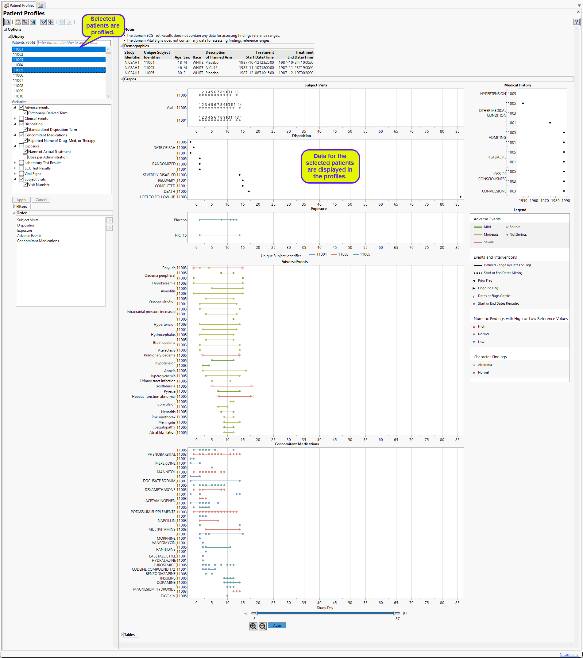

Patients
This widget enables you to select which patients to profile. Hold the Ctrl key to select multiple patients or the Shift key to select contiguous patients among those listed. Shown below is a partial Profile display for three selected patients.

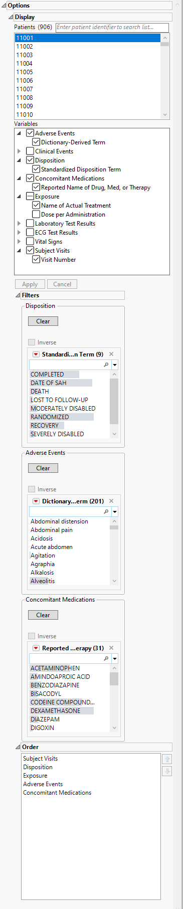

Variables
This widget enables you select the domains and variables to include in your profiles. Click to expand the domains and display the variables that may be selected. Click within the check boxes to select desired domains and variables. Click to apply any changes to the variables to be profiled.
Filters
This widget enables you to display a subset of dispositions, adverse events, and concomitant medications in the graphs. Click the disposition, event, or medication you want to display. Hold the key while clicking to select muliple items.
Order
This widget allows you to specify the order in which the different plots are displayed. Select a category and use the and buttons to move the category up or down in the order sequence.
