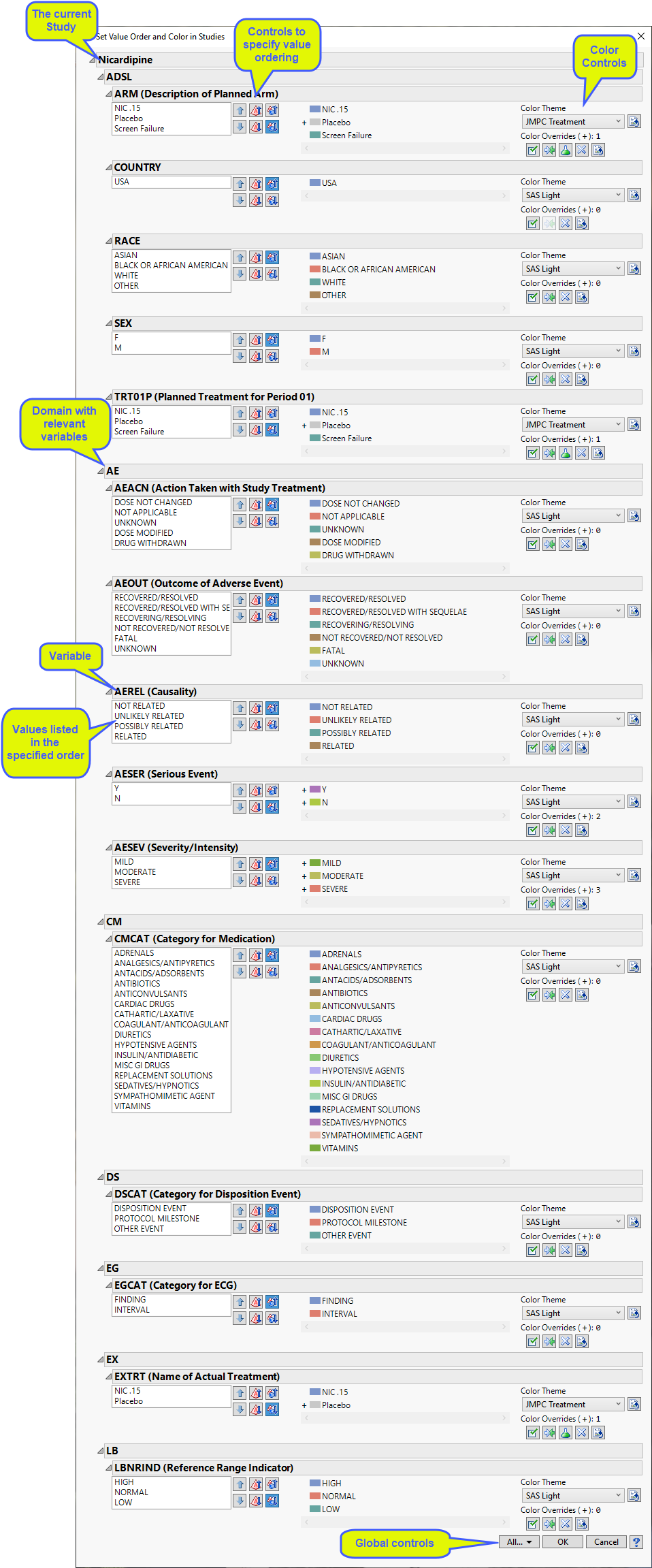

This window has the following elements
• The Study outline label indicates the current study being modified. Click on the arrow to collapse/expand the study.
• A collapsible/expandable outline for each domain and its relevant variables.
• A collapsible/expandable outline for each variable within each domain. Each variable has a field listing the values and a set of controls used for specifying the order in which the values are presented in the report.

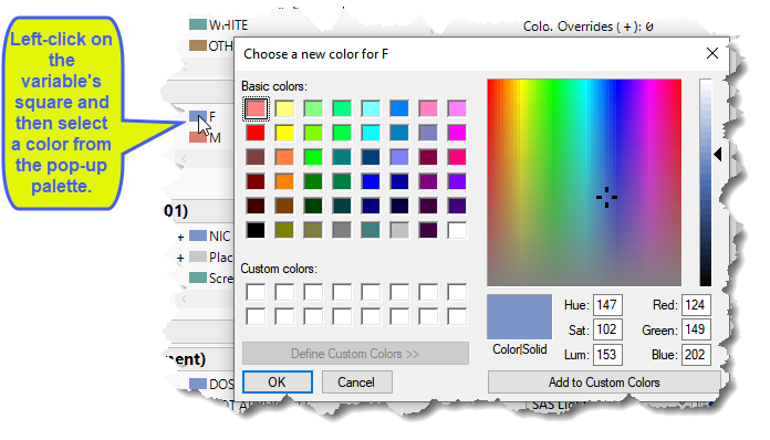

Use these controls to set the color the individual values for each of the variables. You can either set a color theme for the variable (see below) or specify the color for each variable using the pop-up palette.

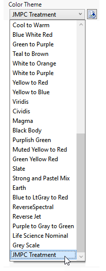

Use the drop-down menu to select the color theme for the variable used in any JMP Clinical report graphic.
Note: The color theme assigns colors to each value dependent on the order of the values. If you change the value ordering, the color each value is assigned also changes to reflect the new ordering.

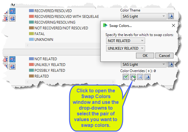

Color overrides allow you to maintain the specified color for each value of a variable in the event you change the value ordering. Overrides are indicated by a plus sign (+) next to the value name and color indicator. You can override a color theme either by specifically assigning colors to each value or by using the controls described below:
• Override all level colors: Click to lock existing selected colors for each value of the variable to be maintained in spite of any value ordering changes.
• Swap colors: Click to swap colors between a pair of values.

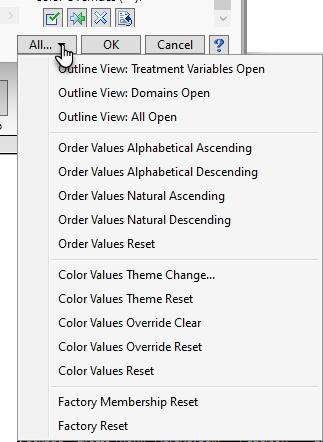

8 Use the drop-down list to make global changes to the window display and/or value ordering. Options include expanding/contracting all Study, Domain and Variable outlines, sorting all values across all variables alphabetically/naturally ascending/descending, globally changing or resetting color themes, clearing or resetting overrides, and resetting all orderings and colors to factory defaults.
There are two options for resetting values and colors. Factory Membership Reset removes domains/variables/values that were individually specified using the Specified Below selection in various options found on the Set Study Preferences dialog or in individual reports, but preserves value order/color preferences for everything else. (This has the same effect on value order/color metadata as refreshing a study.) Factory Reset performs a full reset of membership plus all outline/order/color preferences. (This has the same effect on value order/color metadata as deleting and re-adding a study.)
