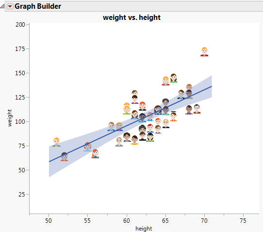

6. Create a graph that uses markers. Figure 9.24 was created in Graph Builder.
7. (Optional) To resize the markers, right-click the graph, and select Graph > Marker Size (or right-click and select Marker Size in some platforms). Medium markers are selected in this example.
8. Click the Graph Builder red triangle and deselect Show > Legend.
Figure 9.24 Pictures Used as Markers

In the Big Class Families.jmp sample data table, the picture column used for markers on graphs.
