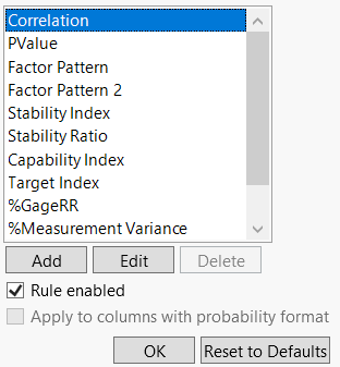

3. Click Manage Rules.
The Conditional Format Rule window appears.
Figure 9.15 Conditional Format Rule Window
All rules are enabled by default. The PValue rule is applied to columns that contain probability values.
From this window you can add, edit or delete a rule.

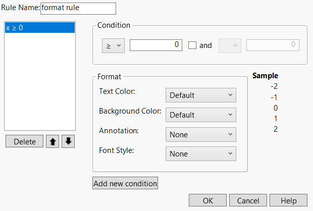

Add a Rule
To add a rule, follow these steps:
1. Open the JMP Preferences window.
2. Select the Reports preference group.
4. Click Add.
The Conditional Format Rule window appears. A placeholder rule appears on the left.
Figure 9.16 Adding a Conditional Format Rule
5. Add and format conditions as described in Add a Condition.
6. Click OK to save the new rule and return to the previous Conditional Format Rule window.
7. Select Rule enabled to enable the rule.

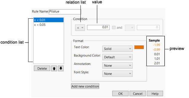

Edit a Rule
To change the conditional formatting of a rule, follow these steps:
1. In the Conditional Format Rule window, select the rule from the list.
2. Click Edit.
The Conditional Format Rule window appears, showing the selected rule’s current conditions.
Figure 9.17 Conditional Format Rule Window
The default rule for PValue includes two conditions. The order of the list indicates the order that the rules are applied. For example, a p-value of 0.04 would not invoke the first rule (x < 0.01) but would invoke the second rule (x < 0.05).
Note: You cannot edit an existing condition within a rule. To edit an existing condition, you must delete the condition and then add it. See Edit an Existing Condition.

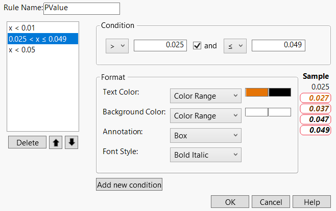

Add a Condition
To add a condition to a rule, follow these steps:
1. Open the rule to view the Conditional Format Rule window.
2. In the Condition area, select a relation from the list and enter a value in the text box.
Or
If you want the condition to include a value range:
Select > or from the relation drop list and enter the value in the text box.
Select the check box, select the < or relation, and enter the value.
3. Format the condition using the procedure described in Format a Condition.
Tip: When you click Add new condition, the condition and its format settings are immediately added to the bottom of the condition list and the Condition and Format areas return to their default settings. Verify your settings before you click Add new condition.
4. After verifying your settings, click Add new condition to add the condition to the rule.
5. Use the Image shown here and Image shown here buttons to position the condition within the list.
Figure 9.18 Example of Adding a Condition with Formatting Rules
6. Click OK to save your changes and return to the previous Conditional Format Rule window.
