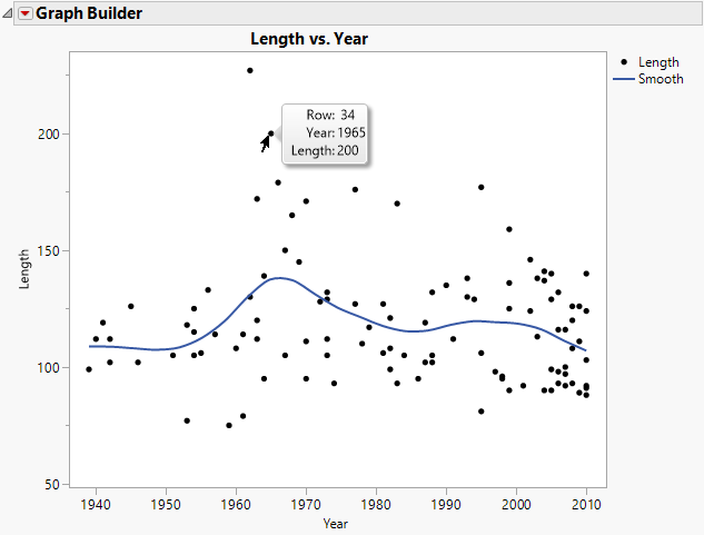

6. Hover over the point in row 34 (Figure 9.60).
Figure 9.60 Initial Hover Label Content for Row 34
For the data point in row 34, you can see the row number, the year in which the movie was made, and the length of the movie (in minutes). Change what appears in the hover labels:

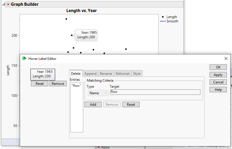

2. Right-click in the hover label and click Edit.
3. At left in the thumbnail, click Row.
4. In the Delete tab, click Add.
“Row” appears under the entries to delete.
5. Click Apply.
In the graph window, you can see that Row is removed from the hover label.
Figure 9.61 Hover Label with Row Removed
6. At left in the thumbnail, click Length (the other entry that you want to remove).
7. In the Delete tab, click Add.
“Length” appears under the entries to delete.
8. Click Apply.
In the graph window, you can see that Length is removed from the hover label, leaving only Year.

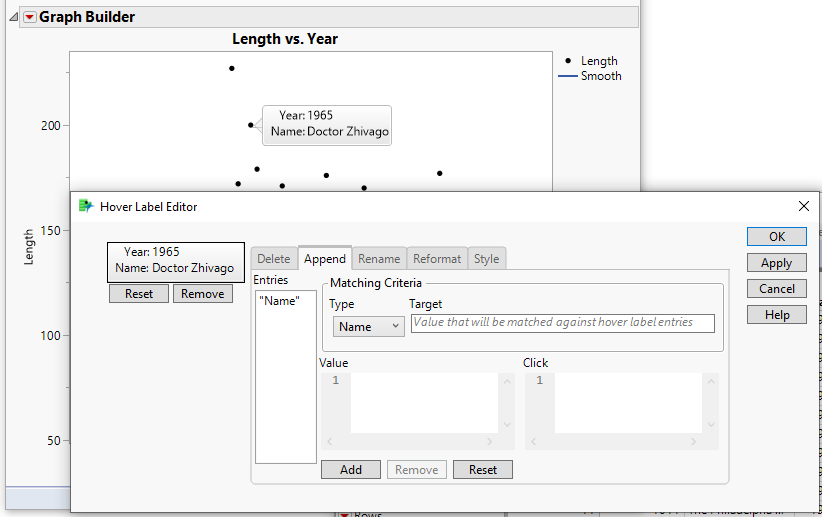

9. Add the movie name and genre:
a. Click the Append tab. Type should be set to Name.
b. Under Target, type Name (the name that you want to add).
c. Under Value, copy and paste the following JSL expression: :Name[local:_firstRow]
Name is the column reference. Brackets indicate to get the corresponding column value for the given index. local:_firstRow is the index, which is a Hover Label Execution Context (HLEC) variable. For details, see Work with the Hover Label Execution Context in the Scripting Guide.
d. Click Add and then click Apply.
In the thumbnail and in the graph hover label, you can see that the name of the movie is added.
Figure 9.62 Hover Label with Name Added

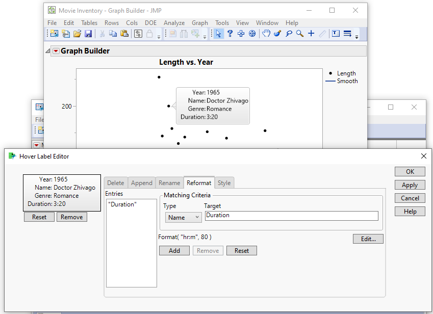

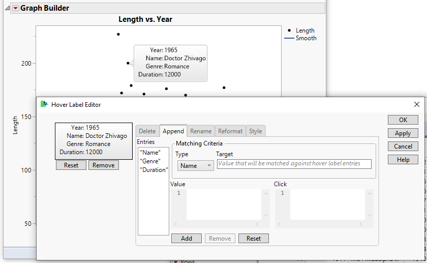

10. Convert the Length data from minutes to hours and minutes:
a. On the Append tab, in the Target box, type Duration (the name of the new hover label that you want to add).
b. Under Value, copy and paste the following JSL expression: local:_Length * 60
local:_Length is an HLEC variable, with the value of the grid entry Length. Length is in the graph, so we have access to this value in the hover label context. For details, see Work with the Hover Label Execution Context in the Scripting Guide.
* 60 converts the duration from minutes to seconds. In order to apply the hours:minutes format, the duration needs to be in seconds.
c. Click Add and then click Apply.
In the thumbnail and in the graph hover label, you can see the Duration label is added. But the value needs to be formatted correctly.
Figure 9.63 Hover Label with Duration Added
d. Click the Reformat tab.
e. Under Target, type Duration (the name of the hover label entry that you want to reformat).
f. Click Edit.
g. Next to Format, select Duration > hr:m and then click OK.
h. Click Add and then click Apply.
On the hover label, you can see that the Duration is now in hours and minutes.

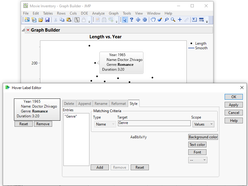

11. Make the Genre values bold:
a. Click the Style tab.
b. Under Target, type Genre (the name of the hover label entry that you want to make bold).
Notice that Scope is set to Values. This bolds the Genre values instead of the name Genre.
c. Click Font.
d. Under Font style, click Bold and then click OK.
e. Click Add and then click Apply.
On the hover label, you can see that the Genre value, Romance, is now bold.
Figure 9.65 Hover Label with Genre Value in Bold

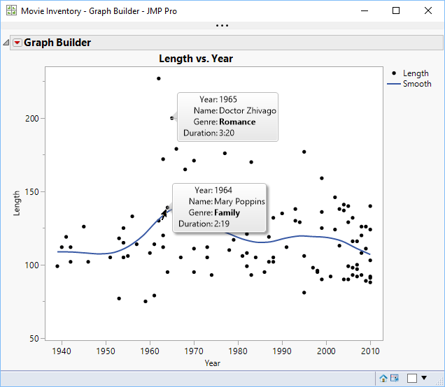

Hover over the other labels to see that they are all updated.
Figure 9.66 Updated Hover Labels

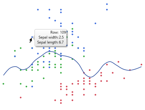

6. Hover over the point in row 109.
Figure 9.67 Hover Label for Row 109

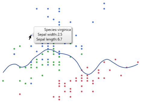

You can see that a Row entry appears in the hover label. You want to replace it with a column and its value from the data table called Species.
7. In the data table, right-click the Species column and select Label/Unlabel.
A label icon Image shown here appears beside the column name in the Columns panel.
8. In Graph Builder, hover over the same data point.
Figure 9.68 Hover Label Showing Species Column
You can see that the Row entry is replaced by the Species column.
Note: If you specify multiple labeled columns, their values appear alphabetically in the hover label.
