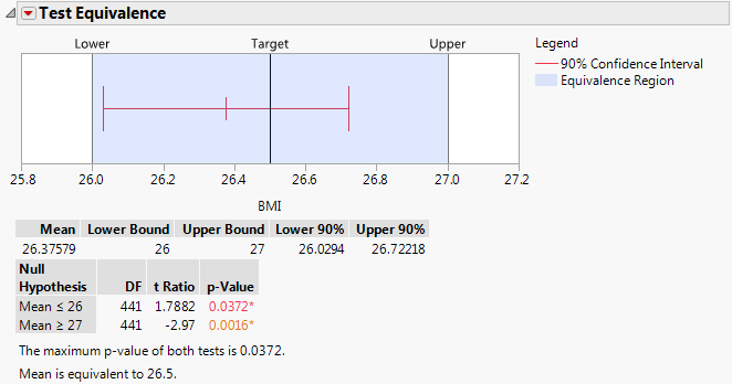

The Test Equivalence report in Figure 3.11 is for the variable BMI in the Diabetes.jmp sample data table. The Hypothesized Mean is 26.5 and the Difference Considered Practically Zero is specified as 0.5.
Figure 3.11 Test Equivalence Report
The report shows the following:
A plot of your defined equivalence region that shows the Target and boundaries, defined by vertical lines labeled Lower and Upper.
A confidence interval for the calculated mean. This confidence interval is a 1 - 2*alpha level interval.
A table that shows the calculated mean, the specified lower and upper bounds, and a (1 - 2*alpha) level confidence interval for the mean.
A table that shows the results of the two one-sided tests.
A note that summarizes the results, and states whether the mean can be considered equivalent to the Target value.
