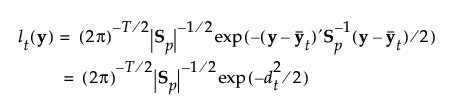

The likelihood for an observation y in group t is estimated as follows:
Equation shown here

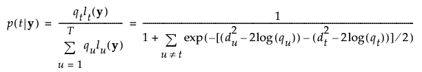

The posterior probability of membership in group t is defined as follows:
Equation shown here
An observation y is assigned to the group for which its posterior probability is the largest.

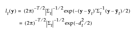

Equation shown here

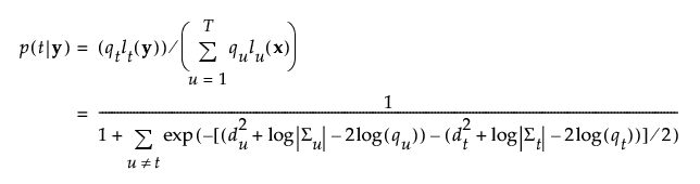

The posterior probability of membership in group t is the following:
Equation shown here
