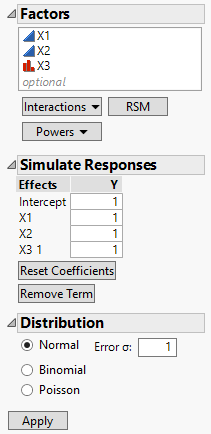

Figure 8.10 shows the Model window for a design with two continuous factors (X1 and X2) and one two-level categorical factor (X3).
Figure 8.10 Simulate Responses Control Window
The window has three sections:
Factors
Simulate Responses
Distribution
The initial Simulate Responses section shows terms for a main effects model with values of 1 for all coefficients. The Distribution section shows a Normal distribution with error standard deviation equal to 1. If you have set Anticipated Coefficients as part of Power Analysis under Design Evaluation in the DOE window, then the initial values in the Simulate Responses section are the values that you specified as Anticipated Coefficients and Anticipated RMSE (Error Std) in the Power Analysis section.

To specify a model for simulated values, do the following:
1. For each term in the list of Effects, enter coefficients for the linear model used to simulate the response values. These define a linear function, L(x, β) = xβ. See the Simulate Responses section in Figure 8.10:
The vector x consists of the terms that define the effects listed under Effects.
The vector β is the vector of model coefficients that you specify under Y.
2. Under Distribution, select a response distribution.
3. Click Apply. A <Y> Simulated column containing simulated values and their formula is added to the design table, where Y is the name of the response column.
