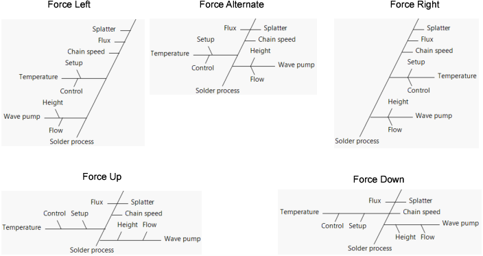

Force Left
Makes all horizontally drawn elements appear to the left of their parent.
Force Right
Makes all horizontally drawn elements appear to the right of their parent.
Force Up
Makes all vertically drawn elements appear above their parent.
Force Down
Makes all vertically drawn elements appear below their parent.
Force Alternate
Draws children on alternate sides of the parent line.
Figure 16.10 Force Options
Force Options
