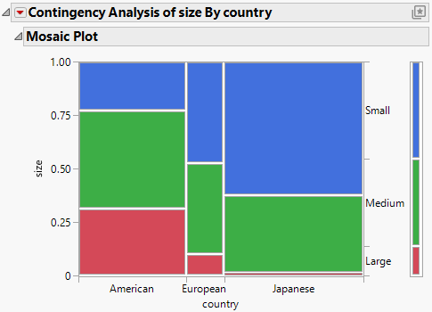

In the Contingency platform, the mosaic plot is a graphical representation of the two-way frequency table, which is also called a contingency table. A mosaic plot is divided into rectangles of varying dimensions; the vertical length of each rectangle is proportional to the proportions of the Y variable within each level of the X variable. The mosaic plot was introduced by Hartigan and Kleiner (1981) and refined by Friendly (1994).
Figure 7.5 Example of a Mosaic Plot
Note the following about the mosaic plot:
The width of the partitions on the horizontal axis represent the number of observations for each level of the X variable.
The proportions on the vertical axis on the right side of the plot represent the overall proportions of the levels of the Y variable for the combined levels of the X variable. These proportions represent the null hypothesis of no association between the X and Y variables.
The scale of the vertical axis on the left side of the plot shows the response probability. The whole axis is equivalent to a probability of one, which represents the total sample.
