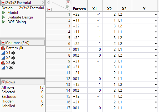

The Make Table button in the Output Options section of the Factorial Design platform creates a data table that contains the runs for your experiment. The example in Figure 13.10 shows a full factorial design with five center points for three factors: X1 (a two-level continuous factor), X2 (a three-level continuous factor), and X3 (a two-level categorical factor). The design uses the default values for the factor levels. The center points are in rows 7, 8, 12, 14, and 17. See Pattern Column.
Figure 13.10 Design Data Table
Design Data Table
The name of the table, shown in the upper left corner, is the design type that generated it.

Pattern Column
The Pattern column contains entries that summarize the run in the given row. You can use Pattern as a label variable in plots.
For a two-level continuous factor, the low setting is denoted by “–”, the high setting by “+”, and a center point by “0”.
For a continuous factor with more than two levels:
For a non-center point, the factor setting is denoted by an integer that corresponds to the value level for the run.
For a center point, the factor setting is denoted by a “0”.
For a categorical factor, the factor setting is denoted by an integer that corresponds to the value level for the run.
