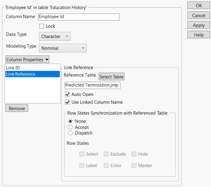

You can also increase portability by using a JMP path variable in the Link Reference path. Figure 5.10 shows an example. Enter a forward slash in the path to share the data tables with both Windows and macOS users. See Path Variables in the Scripting Guide for more information about path variables.

You can specify that the linked column name be used in virtually joined columns. This option lets you specify a shorter column name (for example, Cheese instead of Cheese[Choice]). In the Link Reference column property, select Use Linked Column Name.
Figure 5.10 Link Reference Column Property Definition
