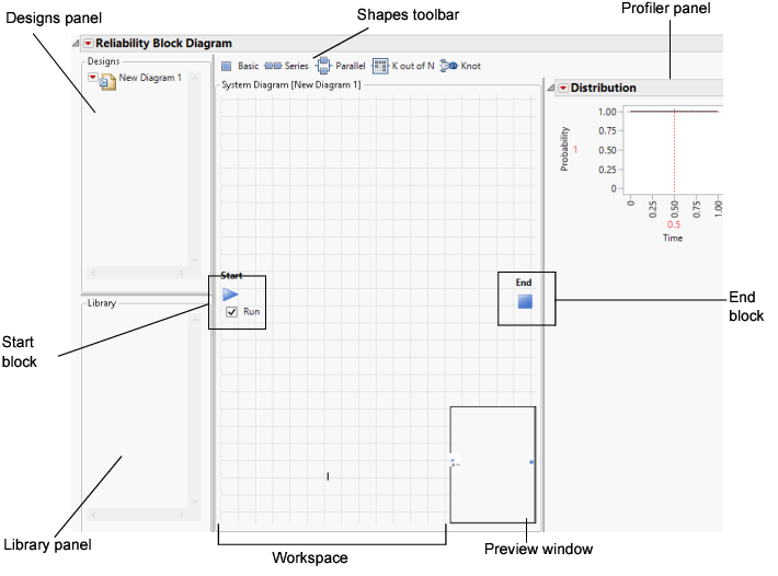

1. Select Analyze > Reliability and Survival > Reliability Block Diagram.
A blank Reliability Block Diagram window appears.
Figure 12.2 New Reliability Block Diagram
Note: The Distribution profiler appears by default.

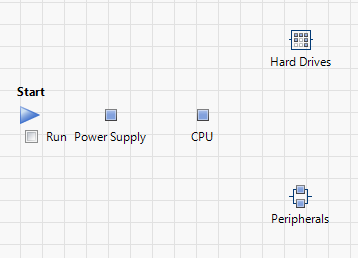

1. Click the Basic icon Image shown here on the Shape toolbar and drag the shape to the System Diagram to the right of the Start block.
2. Select the label, replace New Basic 1 by Power Supply, and press Enter.
Figure 12.3 Basic Shape
Basic Shape
When you click the label or the shape, connection arrows appear. The arrows disappear when you click elsewhere in the template.
3. Drag a second Basic shape to the right of the Power Supply shape.
4. Select the label and type CPU.

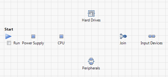

5. Drag a Parallel shape Image shown here to a position to the right and below the CPU shape.
6. Select the label and type Peripherals.
7. Drag a K out of N shape Image shown here to a position to the right and above the CPU shape.
8. Select the label and type Hard Drives.
Figure 12.5 Partial System Diagram
9. Drag a Knot shape Image shown here to the right of the previous shapes.
10. Select the label and type Join.
11. Drag a Series shape Image shown here to a position to the right of the Knot shape.
12. Select the label and type Input Devices.

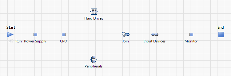

13. Drag a Basic shape to a position to the right of the Input Devices shape.
14. Select the label and type Monitor.
Figure 12.7 System Diagram Showing All Shapes
15. Proceed with Align Shapes.

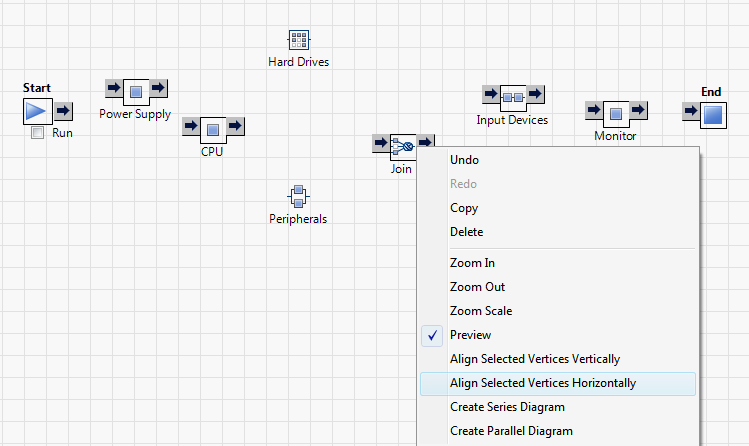

1. To vertically align the shapes for Hard Drives and Peripherals, select the components:
Hard Drives
Peripherals
Tip: To select shapes, drag the cursor around the shapes or press Shift and click each shape.
2. With the shapes selected, right-click one of the shapes and select Align Selected Vertices Vertically.
3. To horizontally align the remaining shapes, select the following components:
Start
Power Supply
CPU
Join
Input Devices
Monitor
End
4. With the shapes selected, right-click one of the shapes and select Align Selected Vertices Horizontally.
Figure 12.8 Align Shapes Horizontally

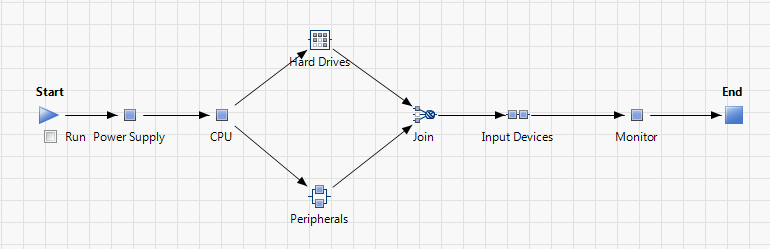

To connect shapes, select a shape to display its connection arrows. Suppose you want to connect shape A to shape B. Select shape A. Drag the right arrow to shape B to indicate that shape A precedes shape B. Drag the left arrow to shape B to indicate that shape B precedes shape A. To connect the shapes in your diagram, select the right arrows to connect to the next shape in the sequence.
1. Select the Start block (blue arrow) to display the connection arrow.
2. Select the single connection arrow Image shown here and drag it to the Power Supply component.
Figure 12.9 Connecting Shapes
Connecting Shapes
3. For each of the following components, click the first component, select its right connection arrow, and drag the arrow to the second component:
1. Power Supply CPU
2. CPU Hard Drive
3. CPU Peripherals
4. Hard Drives Join
5. Peripherals Join
6. Join Input Devices
7. Input Devices Monitor
8. Monitor End block
Figure 12.10 Completed System Diagram
