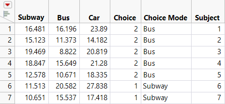

Figure 4.43 Partial Daganzo Trip Table

The new Choice Mode column appears in the data table. Because each row contains a choice made by each subject, another column containing a sequence of numbers should be created to identify the subjects.
9. Select Cols > New Columns.
10. Specify the Column Name as Subject.
11. Click Missing/Empty next to Initialize Data and select Sequence Data.
12. Click OK.
Figure 4.45 Partial Daganzo Trip Data with New Choice Mode and Subject Columns

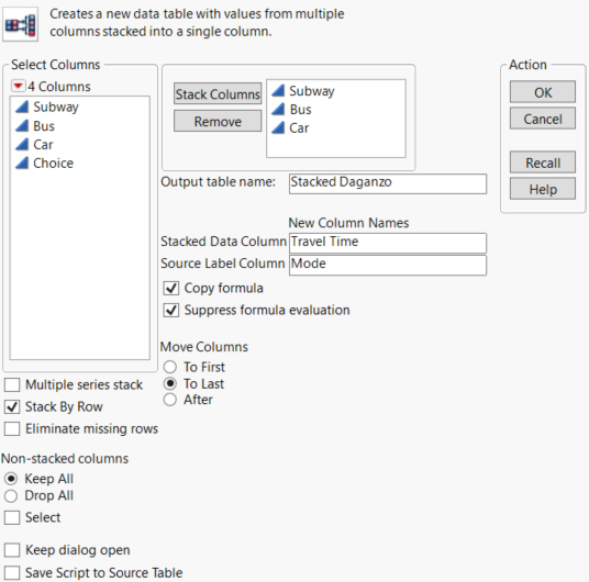

1. Select Tables > Stack.
2. Select Subway, Bus, and Car and click Stack Columns.
3. For the Output table name, type Stacked Daganzo. Type Travel Time for the Stacked Data Column and Mode for the Source Label Column.
Figure 4.46 Stack Dialog for Daganzo Data
4. Click OK.

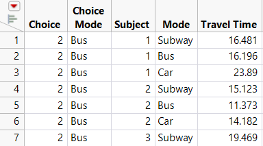

Figure 4.47 Partial Stacked Daganzo Table

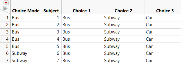

The columns Choice 1, Choice 2, and Choice 3 have been added.
11. Type “Bus” (without quotation marks) in the first row of Choice 1. Right-click the cell and select Fill > Fill to end of table.
12. Type “Subway” (without quotation marks) in the first row of Choice 2. Right-click the cell and select Fill > Fill to end of table.
13. Type “Car” (without quotation marks) in the first row of Choice 3. Right-click the cell and select Fill > Fill to end of table.
Figure 4.49 Partial Subset Table of Daganzo Data with Choice Set

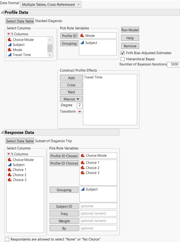

1. Select Analyze > Consumer Research > Choice.
2. From the Data Format list, select Multiple Tables, Cross-Referenced.
3. Specify the model, as shown in Figure 4.50.
Figure 4.50 Choice Dialog Box for Daganzo Data with Multiple Tables

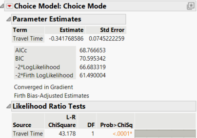

4. Click Run Model.
The resulting parameter estimate now expresses the utility coefficient for Travel Time.
Figure 4.51 Parameter Estimate for Travel Time of Daganzo Data
The negative coefficient implies that increased travel time has a negative effect on consumer utility or satisfaction. The likelihood ratio test result indicates that the Choice model with the effect of Travel Time is significant.
