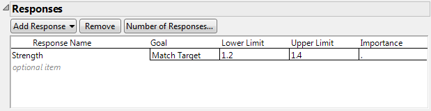

3. Open the Responses section.
Figure A.4 Responses in Custom Design Window
When you designed this experiment, you specified a response Goal of Match Target with a Lower Limit of 1.2 and an Upper Limit of 1.4. Since there is only one response, you did not specify a value for Importance, because it is 1 by default. When you constructed the design table, JMP assigned the Response Limits column property to Strength.

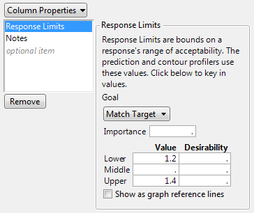

5. In the Coffee Data.jmp sample data table, select the Strength column and select Cols > Column Info.
6. Select Response Limits in the Column Properties list.
Figure A.5 Response Limits Column Property for Strength
Notice the following:
The Goal is set to Match Target.
Importance is missing. When Importance is missing, JMP treats all responses in a given analysis as having equal Importance values. So JMP assigns Strength an Importance value of one.
The Lower limit is 1.2.
The Upper limit is 1.4.
No Middle value is specified.
Because no Middle value is specified, the target is defined to be the midpoint of the Lower and Upper limits, which is 1.3.
No Desirability values are specified.

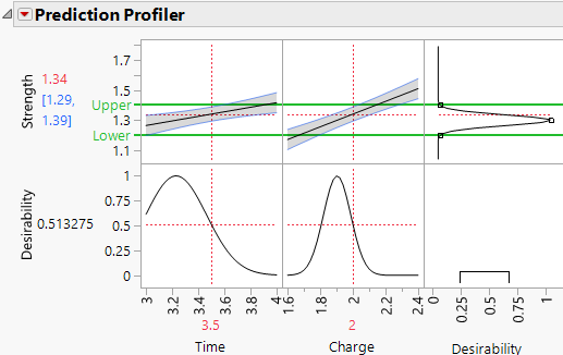

9. In the Coffee Data.jmp data table, click the green triangle next to the Reduced Model script.
10. Click Run.
The Prediction Profiler appears at the bottom of the report.
Figure A.6 Profiler Showing Desirability Function for Strength
The desirability function for Strength appears in the plot at the right above Desirability. This plot appears because the data table contains a Response Limits column property for Strength. The Prediction Profiler also shows reference lines for the Lower and Upper limits for Strength.

13. Click the Prediction Profiler red triangle and select Optimization and Desirability > Maximize Desirability.
The settings for Time and Charge are updated to show settings for the factors that maximize the desirability function for Strength. However, many other settings also maximize the desirability function. SeeContour Profiler in Profilers for information about how to identify other settings that maximize the desirability function.
