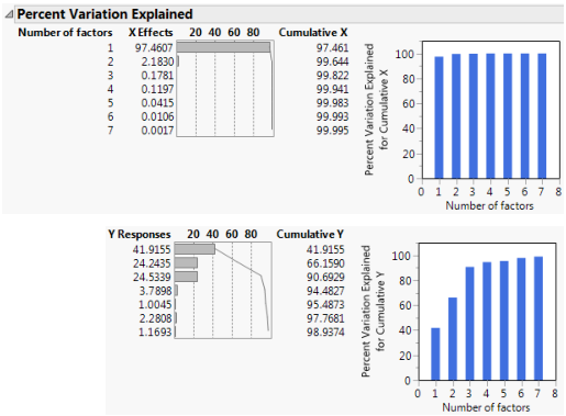

Figure 6.3 Seven Extracted Factors

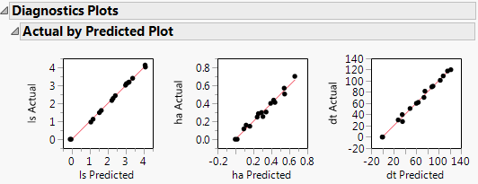

8. Click the NIPALS Fit with 7 Factors Using Fast SVD red triangle and select Diagnostics Plots.
This gives a report showing actual by predicted plots and three reports showing various residual plots. The Actual by Predicted Plot shows the degree to which predicted compound amounts agree with actual amounts.
Figure 6.4 Diagnostics Plots
Diagnostics Plots

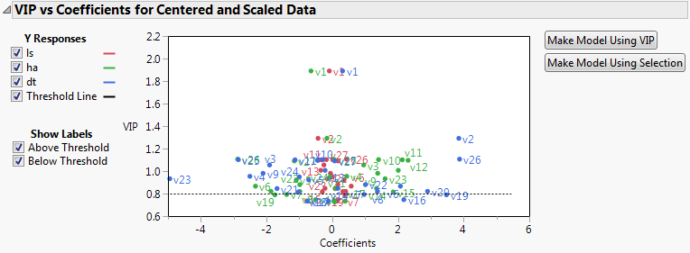

9. Click the NIPALS Fit with 7 Factors Using Fast SVD red triangle and select VIP vs Coefficients Plot.
Figure 6.5 VIP vs Coefficients Plot
The VIP vs Coefficients plot helps identify variables that are influential relative to the fit for the various responses. For example, v23, v2, and v26 all have variable importance for projection (VIP) values that exceed 0.8 and relatively large coefficients.
