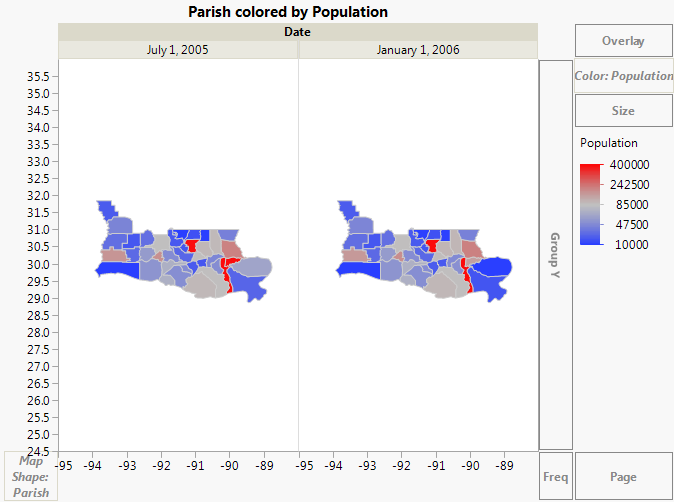

7. Select Graph > Graph Builder.
8. Drag and drop Parish into the Map Shape zone.
The map appears automatically, since you defined the Parish column using the custom map files.
9. Drag and drop Population into the Color zone.
10. Drag and drop Date into the Group X zone.
Figure 12.20 Population of Parishes Before and After Katrina

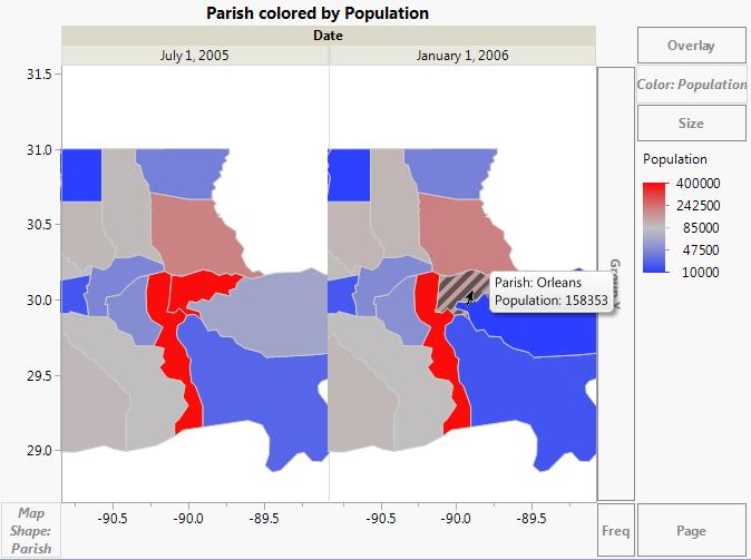

11. Select the Magnifier tool to zoom in on the Orleans parish in both maps (Figure 12.21)
Figure 12.21 Orleans Parish
Orleans Parish
You can clearly see the drop in population as a result of Hurricane Katrina. The population of the Orleans parish went from 437,186 in July 2005 to 158,353 in January 2006.

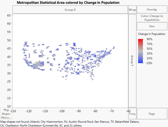

1. Select Graph > Graph Builder.
2. Drag and drop Metropolitan Statistical Area into the Map Shape zone.
Since you have defined the Map Role column property on this column, the map appears.
3. Drag and drop Change in Population to the Color zone.
Figure 12.23 Change in Population for Metropolitan Statistical Areas

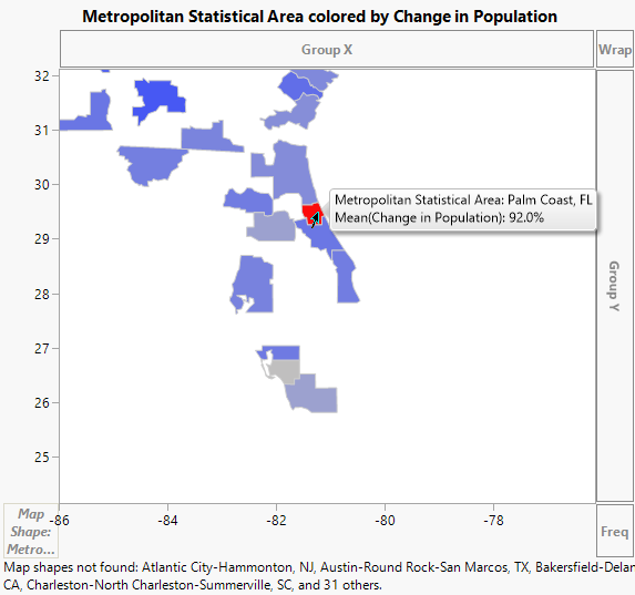

4. Select the Magnifier tool to zoom in on the state of Florida.
5. Select the Arrow tool and click the red area.
Figure 12.24 Population Change of Palm Coast, Florida
6. Select the Magnifier tool and hold down the Alt key while clicking on the map to zoom out.

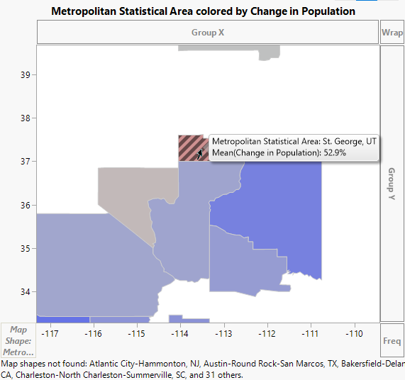

7. Select the Magnifier tool and zoom in on the state of Utah.
8. Select the Arrow tool and click the area that is slightly red.
Figure 12.25 Population Change of St. George, Utah
You can see that the areas of Palm Coast, Florida, and St. George, Utah had the most population change between 2000 and 2010. The Palm Coast area saw a population change of 92%, and the St. George area saw a population change of about 53%.
