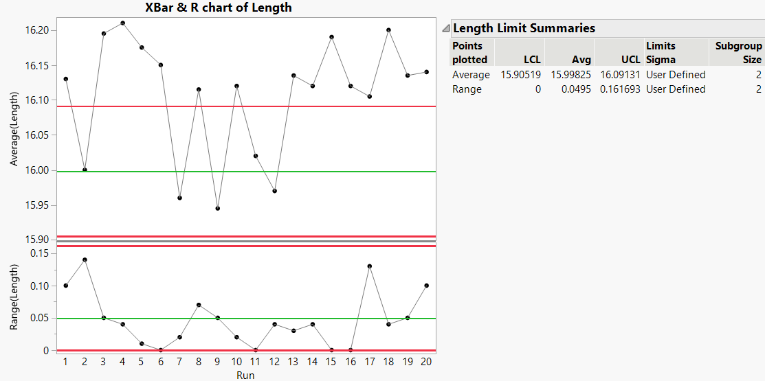

One simple way to specify control limits is to use the Set Control Limits option in Control Chart Builder.
1. Select Help > Sample Data Folder and open Quality Control/New Length Data.jmp.
This is the table that contains your new data.
2. Select Analyze > Quality and Process > Control Chart Builder.
3. Drag Length to the Y zone.
4. Drag Run to the Subgroup zone (at bottom).
5. Right-click in the Average (XBar) chart and select Limits > Set Control Limits.
6. Enter these limits:
LCL - 15.90519
Avg - 15.99825
UCL - 16.09131
These are the historical limits from the Average (XBar) chart in Figure 3.12.
7. Click OK.
8. Right-click in the Range (R) chart and select Limits > Set Control Limits.
9. Enter these limits:
LCL - 0
Avg - 0.0495
UCL - 0.161693
These are the historical limits from the Range (R) chart in Figure 3.12.
10. Click OK.
Figure 3.13 XBar and R Chart of Line Length with Historical Limits
Rather than calculating limits from the data, JMP used the historical control limits that you defined. In the Length Limit Summaries table, notice that the Limits Sigma now says User Defined. Many points now fall outside of the limits. Also, the averages are higher than those of the baseline process. This process appears different from the original process that we used to calculate the baseline control limits.

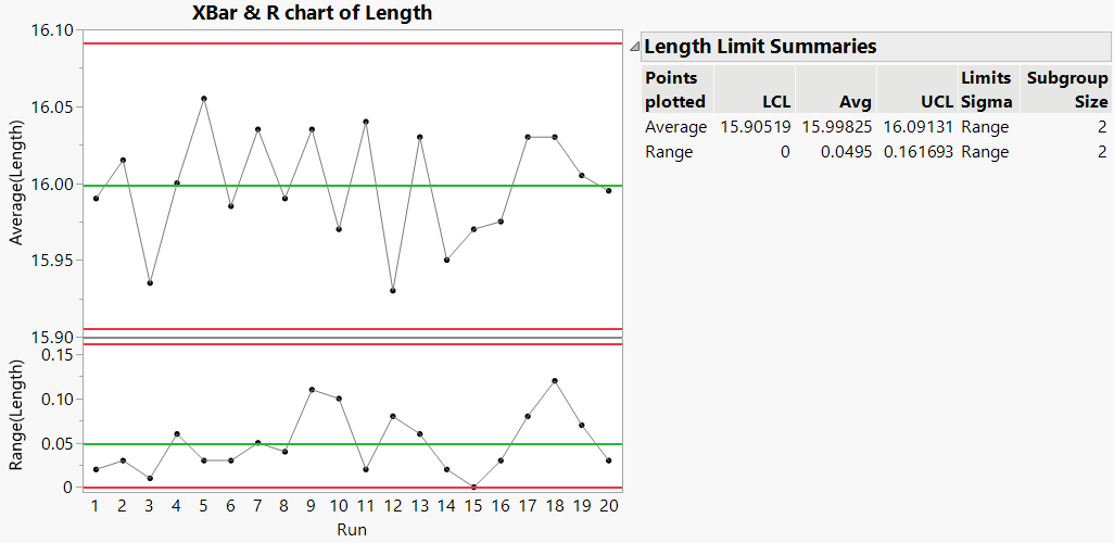

Add a Column Property
Another way to specify control limits is to add the Control Limits column property to a column in your new data table.
2. Select the Length column and click Cols > Column Info.
3. Click Column Properties > Control Limits.
4. XBar is selected, so enter these fixed limits for the Average (XBar) chart:
Avg - 15.99825
LCL - 15.90519
UCL - 16.09131
Leave the value for Subgroup Size as missing. This value is not used in the Control Chart Builder platform.
5. Click XBar > R. Enter these fixed limits for the Range (R) chart:
Avg - 0.0495
LCL - 0
UCL - 0.161693
6. Click OK.
You have entered control limits for XBar and R charts for the Length column. Now you can create a control chart.
7. Select Analyze > Quality and Process > Control Chart Builder.
8. Drag Length to the Y zone.
9. Drag Run to the Subgroup zone (at bottom).
The control chart is identical to Figure 3.13.

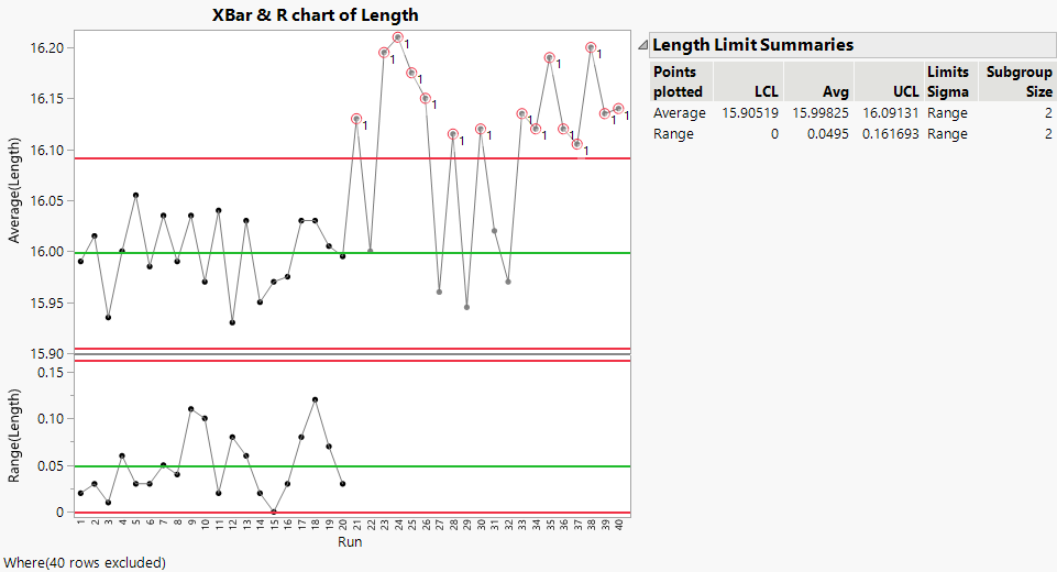

Exclude Rows
Another way to specify control limits is to exclude rows in a data table. One advantage to this method is that you can see both the historical data and new data in the same graph. This can help to visualize and investigate differences when they occur between the data collection periods.
To use this method, you must meet the following criteria:
New and old data must reside in the same data table.
Historical data and new data must all have equal subgroup sizes.
All new data must be excluded in the data table (using Rows > Exclude/Unexclude).
In this example, new data have already been excluded.
1. Select Help > Sample Data Folder and open Quality Control/Combined.jmp.
This table contains old and new data, and the rows corresponding to the new data are excluded.
5. In the XBar chart, right-click and select Warnings > Tests > All Tests.
Figure 3.14 XBar and R Chart of Line Length with Excluded Data
JMP uses only the unexcluded rows (historical data) to create the control limits. The new data (excluded data) are plotted on the graph (dimmed), but these data were not used in any of the calculations. However, when you turn on the tests, all of the data is tested. The new data has many points that fall outside of the control limits and are flagged as failing Test 1 (point is more than 3σ from the average).

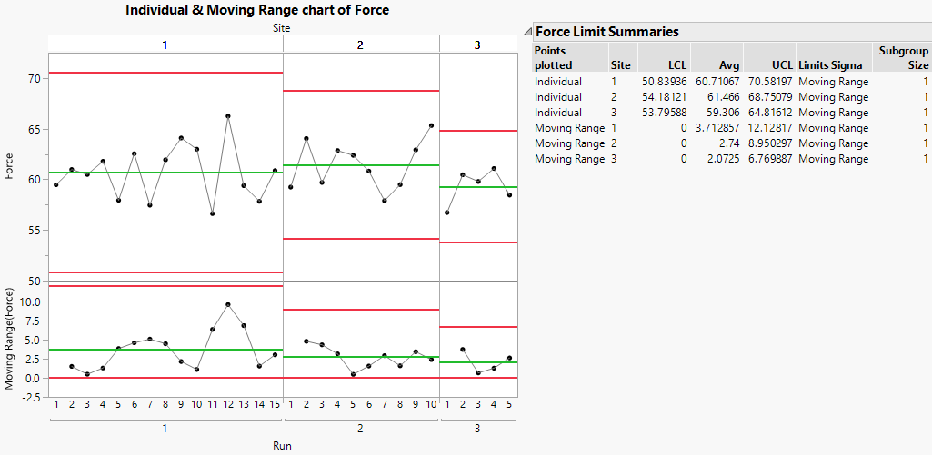

Create a Control Chart Based on Existing Process
1. Select Help > Sample Data Folder and open Quality Control/Phase Historical Data.jmp.
This table contains the existing process data for all three sites.
3. Drag Force to the Y zone.
5. Drag Site to the Phase zone.
Figure 3.15 Baseline Control Chart for Existing Data

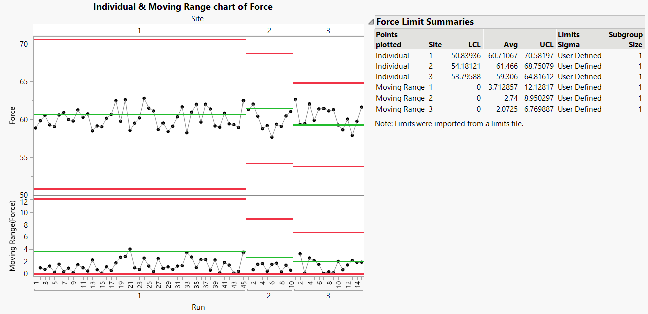

Create a Control Chart Based on Updated Process
1. From the report in Figure 3.15, click the Control Chart Builder red triangle and select Limits > Save Control Limits > in New Table.
This creates a limits table.
2. Save this new limits table to any location, so you can access it later.
3. Select Help > Sample Data Folder and open Quality Control/Phase New Data.jmp.
This data was collected from all three sites after the change was made to the process.
4. Select Analyze > Quality and Process > Control Chart Builder.
5. Drag Force to the Y zone.
6. Drag Run to the Subgroup zone (at bottom).
7. Drag Site to the Phase zone.
8. Click the Control Chart Builder red triangle and select Limits > Get Control Limits. Open the limits table that you saved in step 2.
This applies the historical limits to the new data in the Control Chart Builder report.
Figure 3.16 Control Chart for New Data Based on Historical Limits
Now you can see how the new data (after the process change) compare with the historical process limits (before the process change). None of the points fall outside of the control limits for either the location or dispersion chart. The goal was to reduce variability. Looking at the moving range chart, you can see that most points fall below the average line. For sites 1 and 2, it is clear that the variability of force needed to break the bond between pages and the book spine has been decreased. The decrease at Site 3 is not as strong as at sites 1 and 2. The improvements to the printing process appear to have succeeded in reducing the variability.
