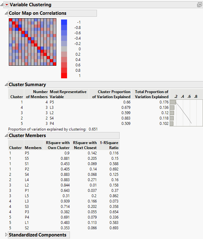

Figure 17.5 Cluster Variables Report for Penta.jmp
The Cluster Summary and Cluster Members reports show that the variables are clustered into five groups, so there are five Cluster Component variables.

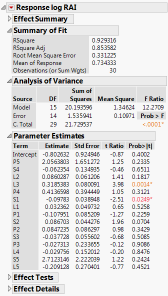

Figure 17.6 Fit Least Squares Report for Model with All Continuous Predictors

The model that includes the five Cluster Components as the only predictors explains a substantial amount of the variation in the response, with an adjusted RSquare of 0.784. The model that uses all fifteen predictors has only a slightly higher adjusted RSquare of 0.853 (Figure 17.6).
