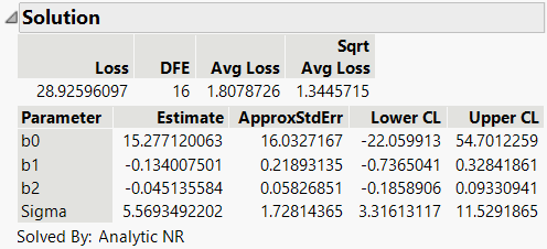

1. Select Help > Sample Data Folder and open Reliability/Tobit2.jmp.
2. Select Analyze > Specialized Modeling > Nonlinear.
3. Select Model and click X, Predictor Formula.
4. Select Tobit Loss and click Loss.
5. Click OK.
6. Click Go.
7. Click Confidence Limits.
The parameter estimates with confidence limits are shown in Figure 15.23.
Figure 15.23 Solution Report
Solution Report
