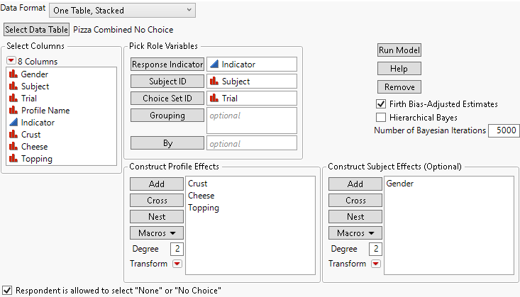

5. Complete the launch window:
Select Indicator and click Response Indicator.
Select Subject and click Subject ID.
Select Trial and click Choice Set ID.
Select Crust, Cheese, and Topping and click Add in the Construct Profile Effects panel.
Select Gender and click Add in the Construct Subject Effects (Optional) panel.
Figure 4.2 Completed Launch Window
6. Check the box next to Respondent is allowed to select “None” or “No Choice”.
7. Click Run Model.

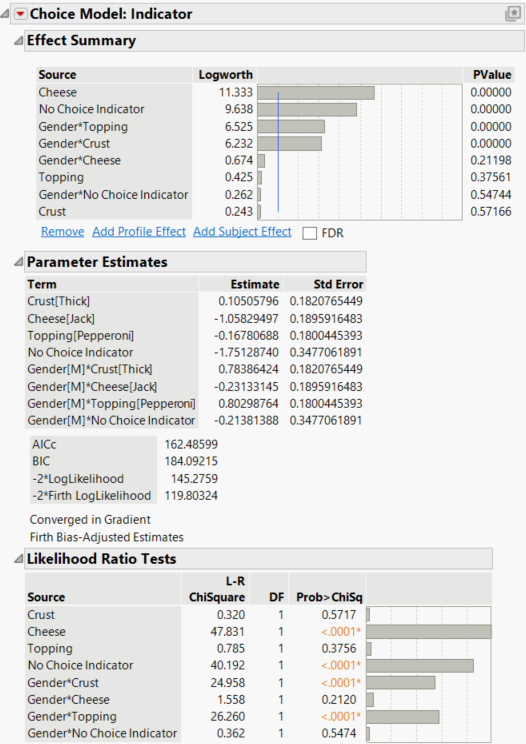

Figure 4.3 Report Showing No Choice as an Effect
The Effect Summary report shows the effects in order of significance. Cheese is the most significant effect, followed by the No Choice Indicator, which is treated as a model effect. The subject effect interactions Gender*Topping and Gender*Crust are also significant, indicating that preferences for Topping and Crust depend on Gender market segments.
