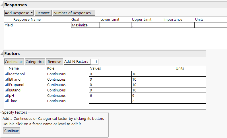

2. Double-click Y under Response Name and type Yield.
3. Select Help > Sample Data Folder and open Design Experiment/Extraction Factors.jmp.
4. Click the red triangle next to Definitive Screening Design and select Load Factors
The factor names and ranges are added to the Factors section.
Figure 8.2 Responses and Factors for Extraction Design

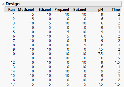

The Definitive Screening Design window updates to show a Design section and a Design Evaluation section.
Figure 8.3 Design
Design

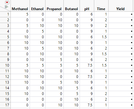

8. Click Make Table to obtain the data table shown in Figure 8.5.
Note: The runs in your design might appear in a different order than the order shown in Figure 8.5.
Figure 8.5 Definitive Screening Design for Extraction Process
