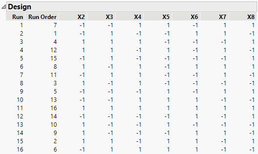

17. Click Make Design.
Figure 5.65 Design
Design

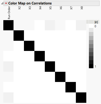

18. Open the Design Evaluation > Color Map On Correlations section.
Figure 5.66 Color Map Showing Absolute Correlations with Run Order
The Color Map shows the following:
The seven continuous factors, X2 through X8, are orthogonal to each other.
Run Order, the linear time trend variable, has extremely low absolute correlation with X2 through X8.
