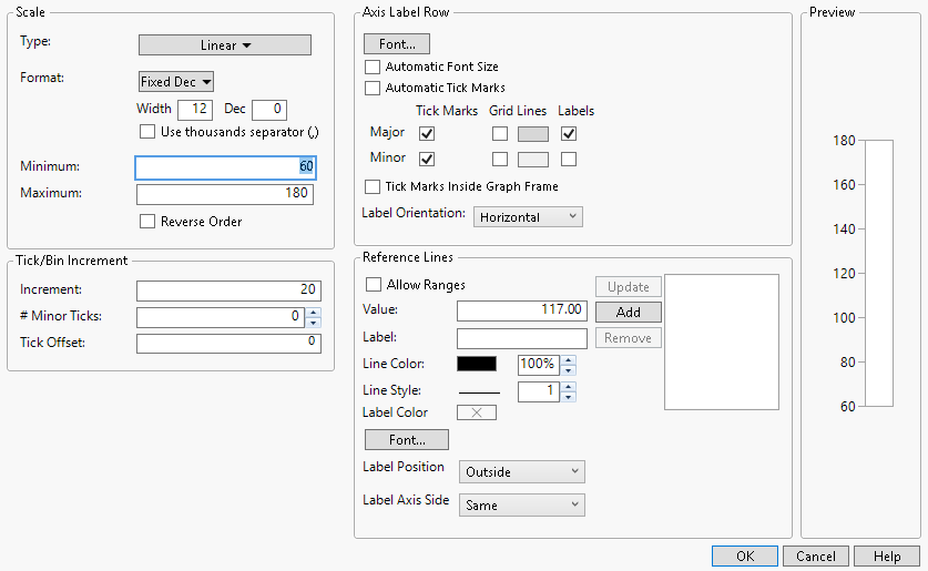

Scale
In the Scale panel, you can do the following:
Change the Axis Scale Type
Change the Numeric Format of an Axis
Establish Minimum and Maximum Axis Values
For plots and charts that contain a numeric axis area, you can change the minimum and maximum values that you want the graph to display.
Notes:
To restore the default minimum, maximum axis settings, and tick increments of an axis, right-click on the axis labels and select Revert Scale. To restore all default axis settings, right-click the axis labels and select Revert Axis.
Select Reverse Order to reverse the axes by reversing the minimum and maximum values. Note that this option is not supported for ternary plots.
Tip: To set a default minimum and maximum axis value for a variable, which avoids making this change every time you run an analysis, see Axis.

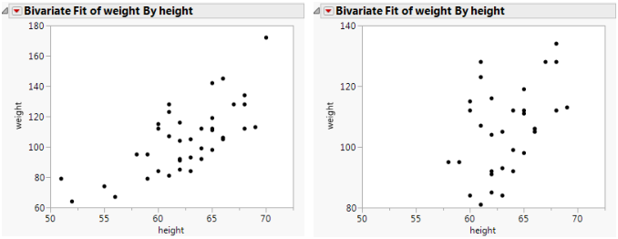

The example on the right in Figure 9.29 is an enlargement of the point cluster that shows between 80 and 140 in the plot to the left. The enlarged plot is obtained by reassigning the maximum and minimum axis values.
Figure 9.29 Rescale Axis to Enlarge a Plot Section

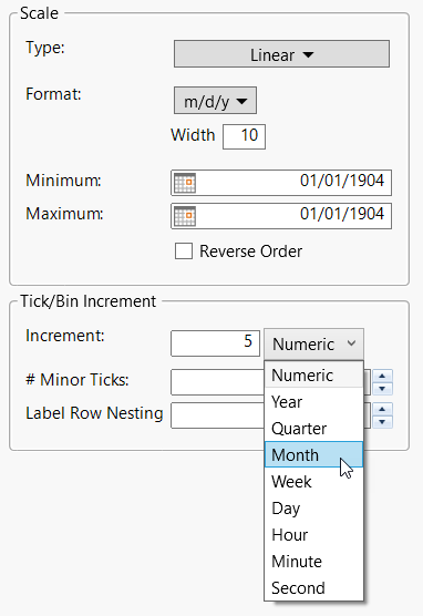

Change Axis Increments
While viewing a graph, you can change the axis increments.
If the axis Format is set to Date, Time, or Duration, a format menu appears beside Increment (Figure 9.30). Select the format for the increments.
Figure 9.30 Selecting the Format for Date and Time Increments
Tip: To set a default axis increment for a variable, which avoids making this change every time you run an analysis, see Axis.

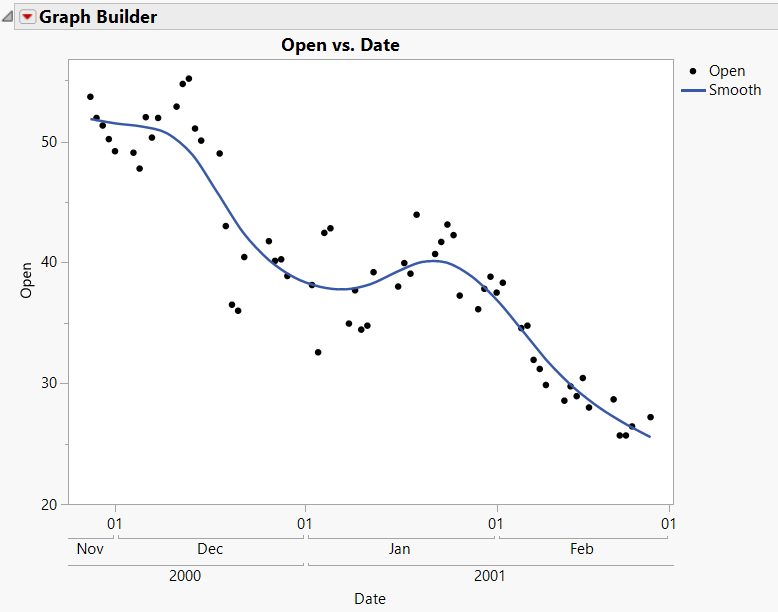

Label Row Nesting
This option appears only if you have selected Date, Time, or Duration as the axis Format. Label row nesting uses multilevel time scale to enable you to split a date axis into multiple rows based on the format. For example, you might put the year on the outermost row, then the month, then the day:
1. Select Help > Sample Data Folder and open Stock Prices.jmp.
3. Drag Date into the X zone.
4. Drag Open into the Y zone.
5. Double-click the X axis.
6. For Format, select Date > ddMonyyyy.
7. Increase the value for Label Row Nesting to 3.
8. Click OK.
9. Click Done to see the finished graph.
Figure 9.31 Example of Label Row Nesting

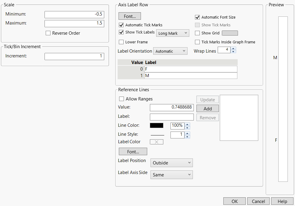

These options can vary depending on whether your axis is continuous or categorical. Figure 9.32 shows axis settings for a categorical axis. Figure 9.28 shows axis settings for a continuous axis.
Figure 9.32 Axis Label Row for a Categorical Axis
Options for continuous axes:
Select Automatic Tick Marks to turn on tick marks only if one or more labels are hidden due to insufficient space.
Add major or minor tick marks, grid lines, or labels, by selecting the corresponding check boxes.
Click the color box to change the color of grid lines.
Select Tick Marks Inside Graph Frame to move the tick marks inside the graph.
Options for categorical axes:
The default is to not show tick marks if all of the labels are visible. To add tick marks, select Show Tick Marks. Change the tick mark style by selecting one of the options.
Select Automatic Tick Marks to turn on tick marks only if one or more labels is hidden (due to insufficient space).
Add grid lines by selecting Show Grid.
Select Lower Frame to add a frame around the labels.
Change the number of lines that text wraps.
Change the labels by entering different values in the Label boxes.

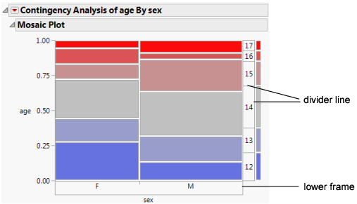

Extend Divider Lines and Frames for Categorical Axes
Extending the vertical divider line(s) between tick labels is useful when there are many levels of a nominal or ordinal (categorical) variable.
To extend the divider line to the x-axis labels, follow these steps:
1. Double-click a nominal or ordinal axis to show the axis settings.
2. Select Show Tick Marks > Short Divider or Show Tick Marks > Long Divider to add the divider lines. Use Lower Frame to add a frame around the axis area.
Figure 9.33 Divider Lines
Divider Lines
