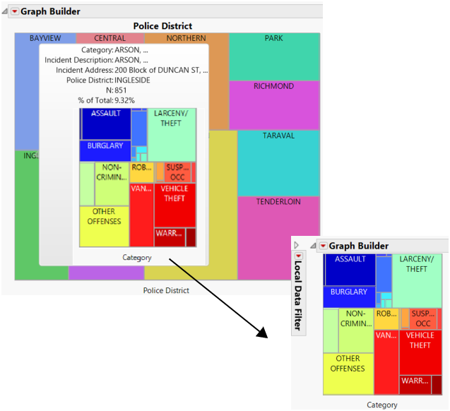

A drill-down graph is created when you click on the thumbnail in a hover label. Clicking on the hover graph opens it in a new window, enabling you to see the graph in more detail and also make modifications such as changing the data filter. For example, click a cell on a treemap to see details about the data in a new window (Figure 12.48). Press Ctrl and click to replace the contents of the last launched window instead of opening a new window.
The Next in Hierarchy column property enables you to define the behavior of categorical drill downs in preset graphs. This column property defines only one level of the drill down, from a category in a grouping role in the current visualization to the category in the grouping role in the next one, launched by the graphlet.

Figure 12.48 shows drilling-down on a cell in a treemap.
Figure 12.48 Example of a Drill-Down Graph on a Hover Label
The following script creates the simplified versions of the treemap presets shown in Figure 12.48.

/* Graph Builder treemap based on the first level of our hierarchy, "Police District" */
gb = dt << Graph Builder(
	Size( 495, 440 ),
	Show Control Panel( 0 ),
	Variables( X( :Police District ) ),
	Elements( Treemap( X ) )

/* configure the graphlet -- a hover label extension that adds a visualization
	thumbnail to the hover label. Clicking on the thumbnail launches the
	associated visualization in its own window (or replaces the graph in the
	current window on a Ctrl-click). */
frame << Set Graphlet(
	// define the thumbnail and launch treemap
	Picture(
		// next-level grouping is retrieved from the Next in Hierarchy property
		local:propColName = local:_groupings[1] << GetProperty( "Next In Hierarchy" );
		local:nextGrouping = Column( local:_dataTable, local:propColName );
		// define the Graph Builder graph for the thumbnail
		Graph Builder(
			Size( 200, 250 ),
			Show Legend( 0 ),
			Show Title( 0 ),
			Show Footer( 0 ),
			Variables( X( local:nextGrouping ) ),
