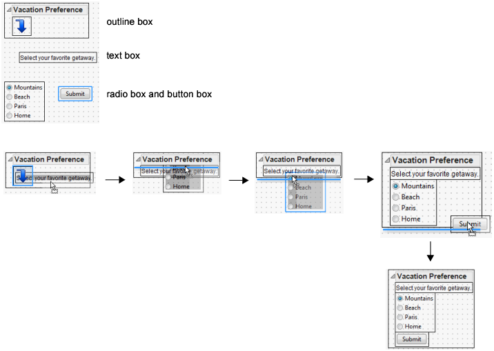

Drag an Object
One way to position objects is by dragging them around the workspace.
The top and left edges of an object align (or snap) to the nearest dotted grid lines as you drag them on the workspace. For a more precise placement, click the Application Builder red triangle and deselect Snap to Grid. You can also turn off Snap to Grid for all applications in the JMP Preferences. Select File (Windows) or JMP (macOS)> Preferences > Platforms > JMP App to change the option.
Position objects in containers instead of positioning them independently on the workspace. For example, place two button boxes in a V List Box to align them vertically.
When you drag an object, press Shift to restrict movement to a single axis (for example, to move the object horizontally without moving the vertical position).
When you drag an object into a container, the arrow indicates where you can drop the object.
When you drag an object over another one, a blue line shows where you can drop the object.
Figure 17.5 shows the various methods for dragging objects inside a container.
Figure 17.5 Examples of Dragging Objects into a Container

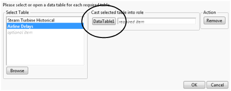

Label
Specifies the string used when prompting the user to open a data table. Figure 17.9 shows the default value.
Figure 17.9 Label in Data Table Prompt Window
Location
Determines how the data table used in the application is selected when the user runs the application.
Current Data Table: Uses the current data table. If no data tables are open, the user is prompted to open one. This option gives users the flexibility to use their own data.
Full Path: Uses the data table specified in the Path property.
Name: Uses the first open data table with the specified name. Otherwise, JMP uses the data table specified in the Path property. Note that if the application is moved to another computer, the link to the data table is broken. Consider storing the data table in a shared location.
Prompt: Asks the user to select an open data table or browse to select a data table.

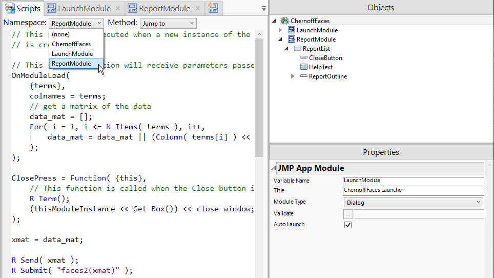

Application and Module Namespaces
To prevent variable names and values from conflicting between scripts, Application Builder automatically creates the Application namespace and a namespace for each module:
In the Application namespace, you write scripts that are executed when the user runs the application. Functions defined in the Application namespace can be used in any module.
In the Module namespaces, you write scripts that are run when an instance of that module is created. If clicking a button in the application opens a new launch window, that launch window is an instance of the module. Two instances of the same module have their own copies of any variables or functions.
To see the scripts in these namespaces, click the Scripts tab and then select the namespace in the Namespace list (or in the Objects panel).
Figure 17.10 Application and Module Namespaces

When an object has multiple scripts, right-click the object, select Scripts, and then select the script name. You can also select the Scripts tab, select the module name from the Namespace list and then select the script name from the Method list. Likewise, to see the application scripts, select Application from the Namespace list.
In each case, the Scripts tab appears with the cursor in the first line of the object’s script.
Tip: To make a poorly formatted script easier to read, right-click and select Reformat Script.
