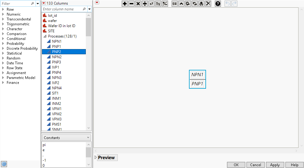

4. Select the first new column, select Cols, and then select Formula.
5. Create the formula NPN1/PNP1 and click OK.
Figure 7.11 Create the Formula NPN1/PNP1

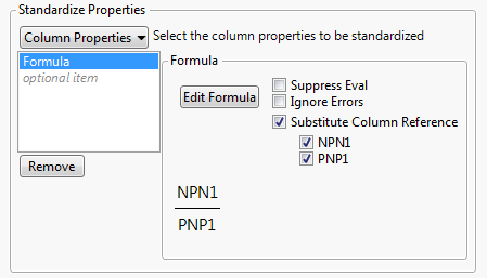

6. Select the three new columns and then select Cols > Standardize Attributes.
7. In the Standardize Properties section, select Formula from the list.
8. Select Substitute Column Reference and leave NPN1 and PNP1 selected.
Figure 7.12 Standardize Properties Options
Note: In this example, we want to change both NPN1 and PNP1. You can deselect the column that you do not want to change in the subsequent formulas.
9. Click OK.
