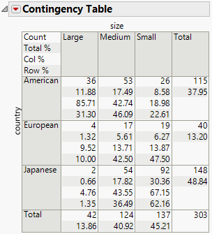

The Contingency Table is a two-way frequency table. There is a row for each level of the X variable and a column for each level of the Y variable.
Figure 7.6 Example of a Contingency Table

In Figure 7.6, focus on the cars that are large and come from America. The following table explains the conclusions that you can make about these cars using the contingency table.
Table 7.1 Conclusions Based on Example of a Contingency Table
Number
Description
Label in Table
36
Number of cars that are both large and come from America.
Count
11.88%
Percentage of all 303 cars that are both large and come from America (36/303).
Total %
85.71%
Percentage of the 42 large cars that come from America (36/42).
Col %
31.30%
Percentage of the 115 American cars that are large (36/115).
Row %
37.95%
Percentage of all 303 cars that come from America (115/303).
Total %
13.86%
Percentage of all 303 cars that are large (42/303).

In the Contingency platform, the Contingency Table contains the following statistics:
Count
The cell frequency, margin total frequencies, and grand total. The grand total is also the total sample size.
Total %
The percent of cell counts and margin totals relative to the grand total.
Row %
The percent of each cell count relative to its row total.
Col %
The percent of each cell count relative to its column total.
Expected
The expected frequency (E) of each cell under the assumption of independence. Computed as the product of the corresponding row total and column total divided by the grand total.
Deviation
The observed cell frequency (O) minus the expected cell frequency (E).
Cell Chi Square
The chi-square values computed for each cell as (O - E)2 / E.
Col Cum
The cumulative column total, calculated from the top of the table to the bottom.
Col Cum %
The cumulative column percentage, calculated from the top of the table to the bottom.
Row Cum
The cumulative row total, calculated from the left of the table to the right.
Row Cum %
The cumulative row percentage, calculated from the left of the table to the right.
