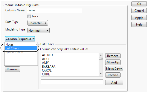

In character columns with fewer than 255 unique values, the List Check property is added to the column where appropriate (Figure 4.37). When the preference Allow 16 Bit List Check Compression is selected, the List Check property is also added to character columns that have more than 255 unique values.
The List Check property restricts the values in the selected column to valid values. The List Check property is not applied when the number of values in the selected column is too great. For example, if the number of values is almost the same as the number of rows, the data table does not add the List Check property to the column.

Figure 4.37 List Check Property Added to a Compressed Character Column
