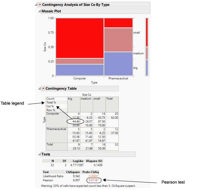

Figure 5.19 Company Size by Company Type

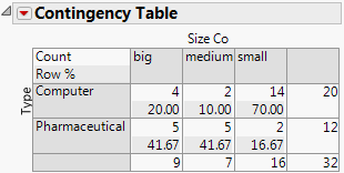

The Contingency Table contains information that is not applicable for this example. Click the Contingency Table red triangle and deselect Total % and Col % to remove that information. Figure 5.20 shows the updated table.
Figure 5.20 Updated Contingency Table
Interpret the Results
The statistics in the Contingency Table are graphically represented in the Mosaic Plot. Together, the Mosaic Plot and the Contingency Table compare the percentages of small, medium, and big companies between the two industries. For example, the Mosaic Plot shows that the computer industry has a higher percentage of small companies compared to the pharmaceutical industry. The Contingency Table shows the exact statistics: 70% of computer companies are small, and about 17% of pharmaceutical companies are small.
Interpret the Test
The financial analyst has looked at only a sample of companies (the companies in the data table). The financial analyst needs to know whether the percentages differ in the broader populations of all computer and pharmaceutical companies.
To answer this question, use the p-value from the Pearson test in the Tests report (Figure 5.19). Since the p-value of 0.011 is less than the significance level of 0.05, the financial analyst concludes the following:
The differences in the sample data are statistically significant.
The percentages differ in the broader population.
