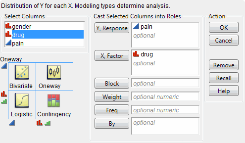

1. Select Help > Sample Data Folder and open Analgesics.jmp.
3. Select pain and click Y, Response.
4. Select drug and click X, Factor.
Figure 4.19 Fit Y by X Window
Fit Y by X Window
5. Click OK.

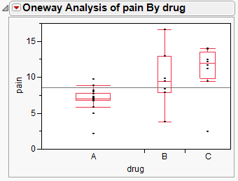

6. Click the red triangle next to Oneway Analysis of pain By drug and select Display Options > Box Plots.
Figure 4.20 Side-by-Side Box Plots

The box plots in Figure 4.20 show these answers:
There is evidence to believe that patients on drug A feel less pain, since the box plot for drug A is lower on the pain scale than the others.
Drug B appears to have higher variability than Drugs A and C, since the box plot is taller.
There is one point for drug C that is a lot lower than the other points for drug C. Hover over the lower point to see that it is row 26 of the data table. That point looks like it is more similar to the data in drug group A or B. The information in row 26 deserves investigation. There might have been a typographical error when the data was recorded.
