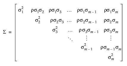

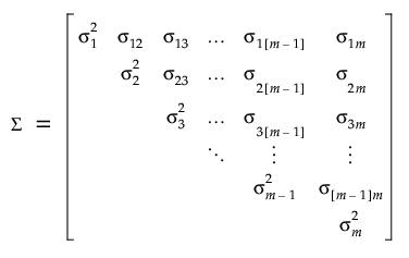

Image shown hereUnstructured Covariance Structure
Equation shown here
Here, the variance among observations taken at time j is:
Equation shown here
The covariance between observations taken at times j and j is:
Equation shown here
The variances are allowed to differ across the levels of the repeated column. The covariances between observations at different levels is unique.

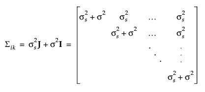

Image shown hereCompound Symmetry Covariance Structure
In JMP, a compound symmetry covariance structure is implemented using a mixed model with independent errors approach. Random effects are classified into two categories: G-side or R-side. See Searle et al. (1992).
The G-side random effects are associated with the design matrix for random effects. The R-side random effects are associated with residual error. Within-subject variance is part of the design structure and is modeled on the G-side. Between-subject variance falls into the residual structure and is modeled R-side. The variances in the independent structure are modeled in the following manner:
The random effects G-side variance is modeled by sik ~ iid N(0, σs2).
The R-side variance is modeled by eijk ~ iid N(0, σ 2).
Then the covariance matrix is defined as follows:
Equation shown here
where J is a matrix consisting of 1s and I is an identity matrix.

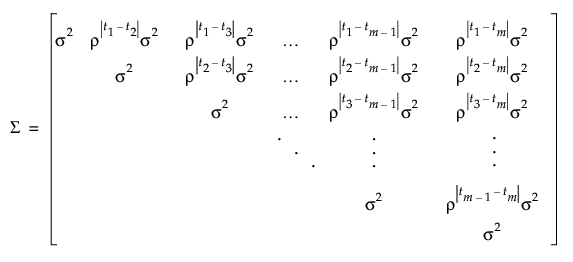

Image shown hereAR(1) Covariance Structure
Equation shown here
Here tj is the time of observation j. In this structure, observations taken at any given time have the same variance, σ2. The parameter ρ, where -1 < ρ < 1, is the correlation between two observations that are one unit of time apart. As the time difference between observations increases, their covariance decreases because ρ is raised to a higher power. In many applications, AR(1) provides an adequate model of the within subject correlation, providing more power without sacrificing Type I error control.

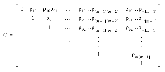

Image shown hereAntedependent Covariance Structure
The antedependence model is a general model that is flexible and allows the correlation structure to change over time. In this model, the correlation between two observations at adjacent time points j - 1 and j is unique and is denoted ρj[j1].
The correlation between pairs of observations at time points j and j that are not adjacent is the product of all the adjacent correlations in between.
Equation shown here
For example, the correlation between the pair of observations at time points j=2 and j=6 would be ρ21ρ32ρ43ρ54.
The correlation matrix is defined as follows:
Equation shown here

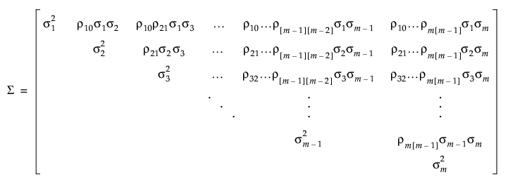

Two options in JMP use this correlation matrix:
The Antedependent Equal Variance structure assumes equal variances across observation times while still allowing for the correlations to change. The variance among observations at any time is σ2 and the covariance matrix is Equation shown here.
The Antedependent structure allows the variance among observations at any given time to vary. Denote the variance among observations taken at time j is Equation shown here. Then the covariance matrix is defined as follows:
Equation shown here
