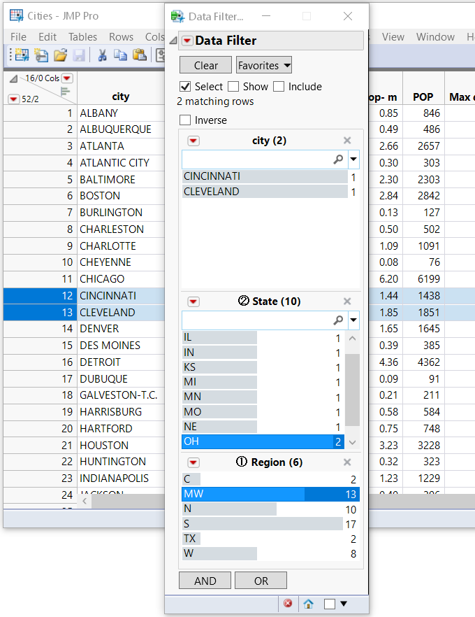

Conditional Data Filters
For filter columns with hierarchy, you can use the Conditional option to filter what appears in the column lists. For example, you could filter by region so that only the states in the selected region appear in the list.
Note: If there is more than one OR group, the conditional filter is not available.
The following example illustrates how the Conditional option helps show the subcategories clearly, without the extra categories that do not belong.
1. Select Help > Sample Data Folder and open Cities.jmp.
2. Select Rows > Data Filter.
3. In the Data Filter window, select city, State, and Region, and then click Add.
The Data Filter window appears, showing a list for each variable.
4. Click the Data Filter red triangle and select Conditional.
5. Select MW in the Region list.
6. Select OH from the State list.
The cities that are in Ohio and in the Midwest region are selected in the data table. In the Data Filter window, only Midwestern states appear in the State list, and only cities in Ohio appear in the cities list.
Figure 9.11 Using the Conditional Option
The circled number in front of the column name indicates the order in which the column values were selected. In Figure 9.11, Region was selected first, so it has a circled “1” in front of the column name. State was selected second, so it has a circled “2” in front of the column name.
When you rearrange hierarchical filters that are in ascending order, the filter number changes to match the ascending position in the hierarchy.
To clear the selections and reset the order of the hierarchy, click Clear.

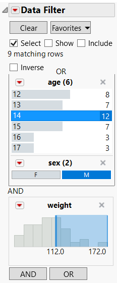

Grouped by AND in Data Filters
When you add a filter column, click AND, and add another filter column, you create a filter group. Within that group, columns that meet all criteria are selected in the data table.
When you then click OR and add one or more filters, you create a second filter group. With Grouped by AND deselected, this is the default behavior.
If you select Grouped by AND, you reverse the behavior.
The following example shows what happens when Grouped by AND is selected.
1. Select Help > Sample Data Folder and open Big Class.jmp.
3. Click the Data Filter red triangle and select Grouped By AND.
4. In the Data Filter window, select the age column and click Add.
5. Click OR and add the sex column.
sex is added to the same group as age.
6. Select 14 from the age filter, and select M from the sex filter.
age and sex are in the same group. In the data table, rows that meet either the age OR sex conditions are selected. That is, all 14-year-olds and all males are selected in the data table.
7. Click AND and add the weight column.
A new group is added.
8. Move the left weight slider to approximately 112.
Another filter group has been added. The second filter group limits the selection to those rows where weight is greater than 112.
The two filter groups together select rows that satisfy the condition in the first group AND the condition in the second group, that is, a student who is 14 or any male but must weigh more than 112.
Figure 9.12 Data Filter with Grouped by AND Condition
