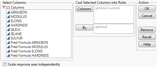

To launch the Surface Plot Profiler directly, select Surface Plot from the Graph menu. If there is a data table open, this displays the window in Figure 5.5. If you do not want to use a data table for drawing surface plots, click OK without specifying any columns. If there is no data table open, you are presented with the default surface plot shown in Figure 5.13.

Figure 5.5 Surface Plot Launch Window
Columns
Specifies the columns that you want to plot. Only numeric variables can be assigned to the Columns role.
By
Specifies a variable to create separate surface plots for each level of the variable.
Scale response axes independently
Assigns a separate scale to each response on the surface plot.
Note: When not selected, the axis scale for all responses is the same as the scale for the first item entered in the Columns role.
