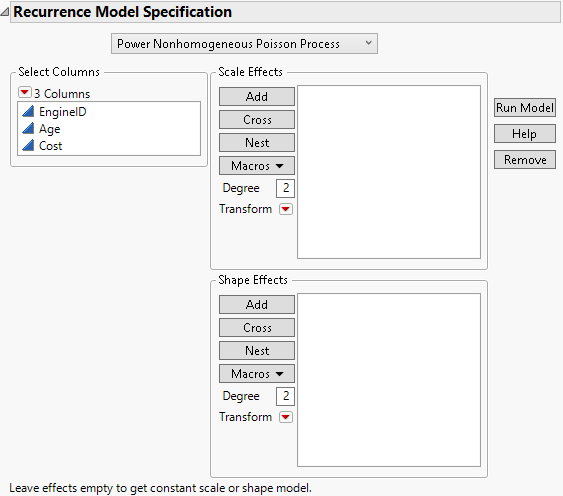

Select Fit Model from the Recurrence Analysis red triangle menu to produce the Recurrence Model Specification window shown in Figure 7.5.
Figure 7.5 Recurrence Model Specification

For the Recurrence Model Specification window (Figure 7.5), if you include Scale Effects or Shape Effects, the scale and shape parameters in Table 7.1 are modeled as functions of the effects. To fit the models with constant scale and shape parameters, do not include any Scale Effects or Shape Effects.
The Homogeneous Poisson Process is a special case compared to the other models. The Power NHPP and the Proportional Intensity Poisson Process are equivalent for one-term models, but the Proportional Intensity model seems to fit more reliably for complex models.
Click Run Model to fit the model and see the model report.

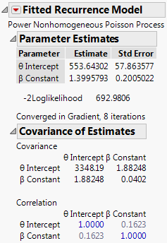

Figure 7.6 Model Report
Model Report
