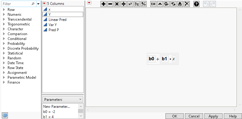

Column Linear Pred that contains a formula for the linear portion of the link function. To view the formula, click the plus sign to the right of Linear Pred in the Columns panel. The model formula includes the initial estimates for the parameters b0 and b1. Initial parameter values are set when you define a formula. These values are shown in the formula element panel in the lower center of the formula editor window.
Figure 23.12 Linear Predictor Formula with Initial Parameter Estimates

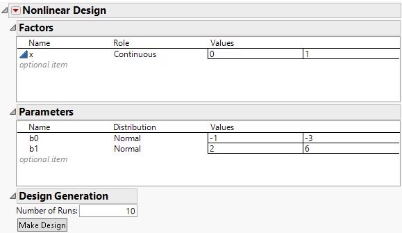

Figure 23.13 Nonlinear Design Window
The Factors section shows the factor x with the specified values of 0 and 1. The Parameters section shows the two model parameters with each prior distribution set to a normal distribution. JMP computes default Values based on your initial settings for the parameter values. You can change the assumed distribution and ranges for the parameters in this section. Leave all settings as they appear. The default number of runs is 10.

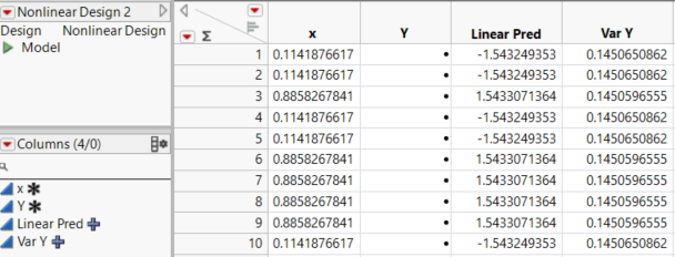

This adds the 10 run design to One Factor Logistic Design.jmp (Figure 23.13). Your design table is different because the optimization algorithm has a random component.
Figure 23.14 Augmentation of One Factor Logistic Design.jmp
The model saved to the data table is a nonlinear model to fit the “Linear Pred” used in the creation of the design. After you collect your data, use a generalized linear model (GLM) with a logit link function to model the effect of x on Y.
